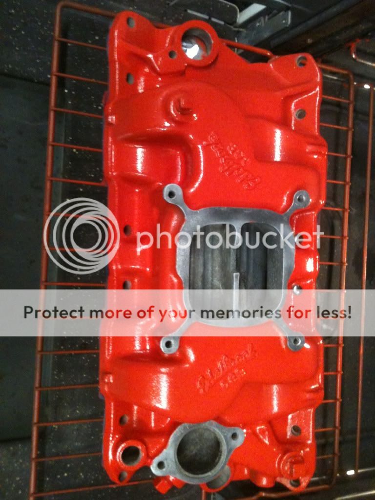

I am going to be running a 68 327 in my '64 and want to run some script valve covers to make it look a little more correct for the year. My engine does not have the PCV provision at the back of the block. I found a vintage edelbrock intake that allows the use of a oil fill tube, so I was going to run a breather cap on that. The problem is then where do you put the PCV valve? After doing a little research I found a pic of a guy that modified his edelbrock intake to fit a PCV in front of the distributer.
I thought this was a clean look and am thinking about having my intake modified to do the same. Just wanted to run it by the nova gurus to see what you thought! I'm not even close to being ready for the engine, but it was just something I was thinking about...
Here is a pic of the intake I want to use.

I dug this back up to show what I ended up doing with my manifold. I had the machine shop put in a threaded port for the PCV right into the manifold. It's a common part number that you can pick up from the parts store. I'll go down and get a 90 degree bent piece of tubing to run to the front port on my Edelbrock carb. I will also run a breather cap on the top of the oil fill tube. I was pretty excited about it! Now I can run my script covers!

Thats a smart idea.. Clean looking and allows the use of PCV..
I remote mounted my PCV valve and breather in two small seperate baffled canisters. My thinking is it lets the engine oil vapor cool off some and condense in the PCV canister (so Im not in-taking oil vapors) and the breather canister does the same to keep oil vapors from entering the engine compartment. And it cleans up the top of the engine so there aren't any breathers on top.
But I really like your idea to keep the valve covers clean looking and makes the engine look like its a sealed system when it actually is a better PCV controlled vented system.
Good job making what you wanted, which was a difficult call out, WORK... JR
#27 ·
Thank you! I used 2 different powders, a silver base with a Chevy orange top coat. It was a pita, but I used q-tips to remove the orange powder from the cured silver.
Thank you! I was hoping to keep it clean, and I like the "old" look of those script covers! :)
