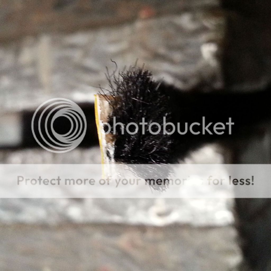

I’m having a hell of a time getting my quarter windows to stay on track, or even start to roll down on track. I’ve got new guides and window channel. I glued the guide channel to the glass, as instructions say, and put the guide in from the bottom of window channel and pushed it as snug as think I could. I set the glass in position at the top (rolled up). When I rolled it down, it immediately comes off track at the bottom. It’s like when the regulator starts to widen (roll down) it pulls the glass out of the window channel with guide channel attached. Instead of going up\down, it pulls it towards where the window channel is bolted up first before going down.
