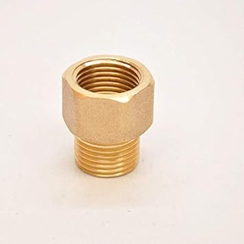

You might be able to use a 3/8" male npt to 1/2" female npt adapter (link shown below) to fit your current temp sending unit into the new head.
Good idea! I will need to check to see about space...Currently using passenger head hole--back near #6... Header might be in the way... Also have a possible option at front of intake...
i was thinking the same thing for you gauge fix. i bet you could find that way cheaper at the local hardware or plumbing supply.
Discussion starter · #35 ·
Yes that's a good idea too! Checked it out today and there is room to use the adapter and still put the sender on the passenger head. The intake hole currently plugged is right up against radiator hose so that won't work... Thanks guys!
