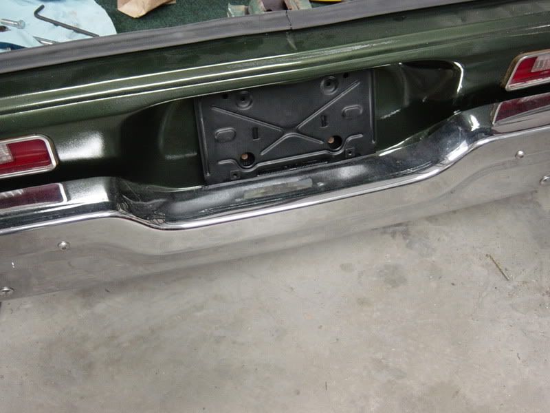

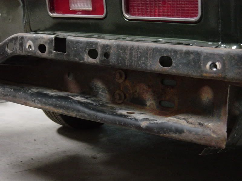

Here are my pics with insufficient lighting in my garage. I took these when I had only two bolts on, I was using the jack to figure out how I wanted to space it out to make it look the best. It came out a fuzz different than it is here, but you get the idea.

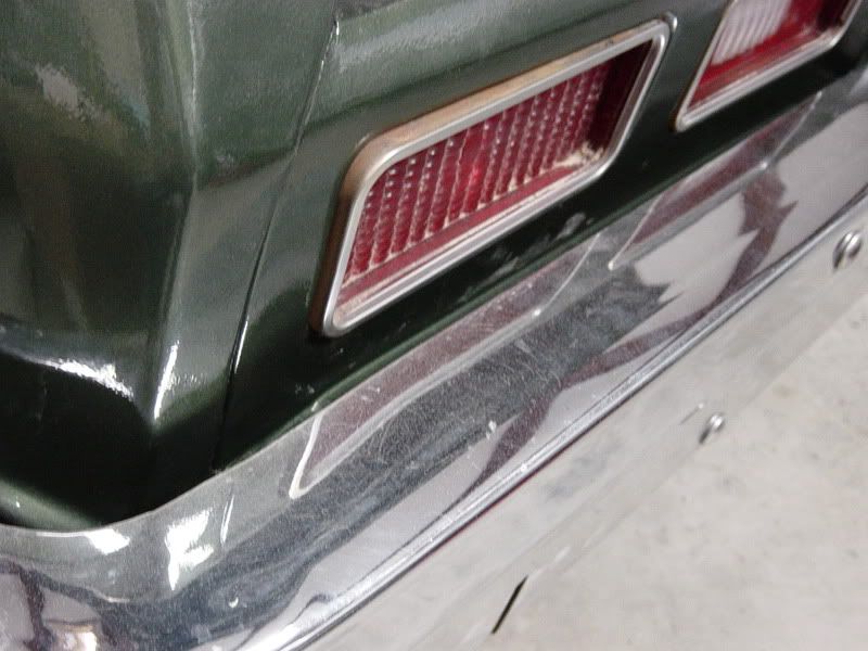

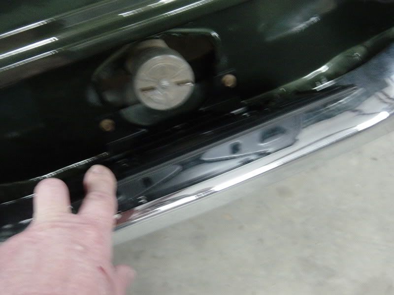

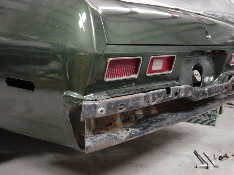

Well my car is in a million pieces but maybe this picture will help. I will also be getting the fiberglass filler for the rear. I don't like the way the bumper looks when against the rear unless the bumper is modified (cut) to be shorter on the sides to match the older (69-72) bumpers. The front is made of metal for the most part. Only the sides are plastic.
