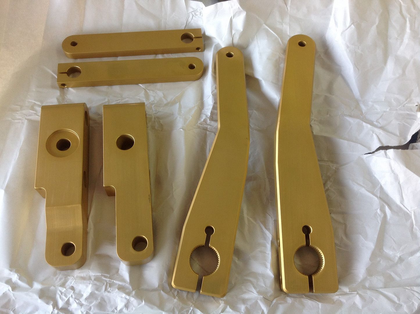

This was some type 2 gold anodize I had done on my steering arms and sway bar end links. Had to have professionally polish, anodize and strip 2-3 times to get show quality.
I guess what I am trying to say is, it is a lot of work and expense and you still might be dissapointed.
