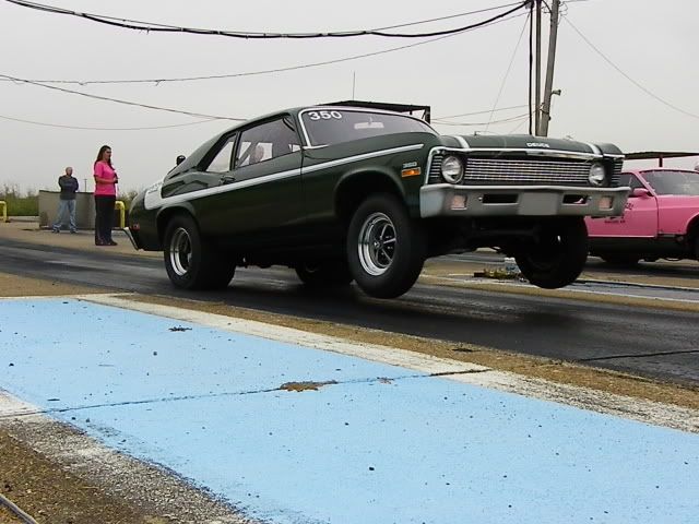

Been having a blast running our Yenko Deuce thus summer. We tried to keep it as close to stock/old school as we could, including the steel SS/Yenko wheels, backhalved, 355SBC on gas, PG and ladder bar Dana 5:13 RE. Best ET 6.483 1/8 mile.

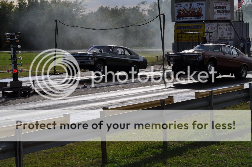

First pic I think is really cool, a couple of Novas launching together. Both cars run right around the 6.50 mark, so makes for some close racing. The other Nova runs a BBC, so fun to see if I can beat him to the stripe with our mouse motor.

Nice looking car. I can appreciate the stock looking race car idea. I didn't stay as strict to it as you did, but I wanted no big scoops, no lettering or decals, and the dash, door panels and carpet are still in the car. I tried to keep the fiberglass to the hood and bumpers, and all the glass in the car. :clap:

You're getting a LOT more out of your 355 than I am. What's your secret?
50 Posts
Discussion Starter #13
No secret that I know of.
GM block, alum heads, alum intake w/reworked Holley carb, Crane roller cam, 13.5-1 comp, big tube headers. 560HP or so.
