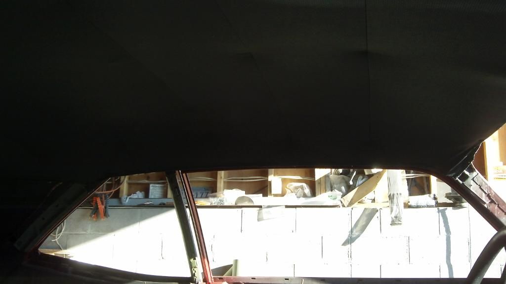

im installing a headliner in my 71 and i got the front and back glues in and everything looks nice and tight but when i go to do the side im getting wrinkles in between the bows. here are some pics of it.
iv been reading online and most people say using a hair dryer should get small wrinkles out but i want to make sure these arent to big.
are these wrinkles to big to use heat to get rid of?
thanks

thanks guys. i got it fixed, the problem was that the listings werent cut all the same length so when i went to pull it tight one was longer then the other so it caused wrinkles, cut them all to the same length and re cliped them and glued in the passenger side last night, i should be finishing it up today.

here are the pics
hopefully some of the small wrinkles will go away when it gets hot in the car with the windows in it.
Not bad and I'm sure some of the little wrinkles will disappear in the heat. I did mine and some disappeared and some remain but all in all it looks fine.
