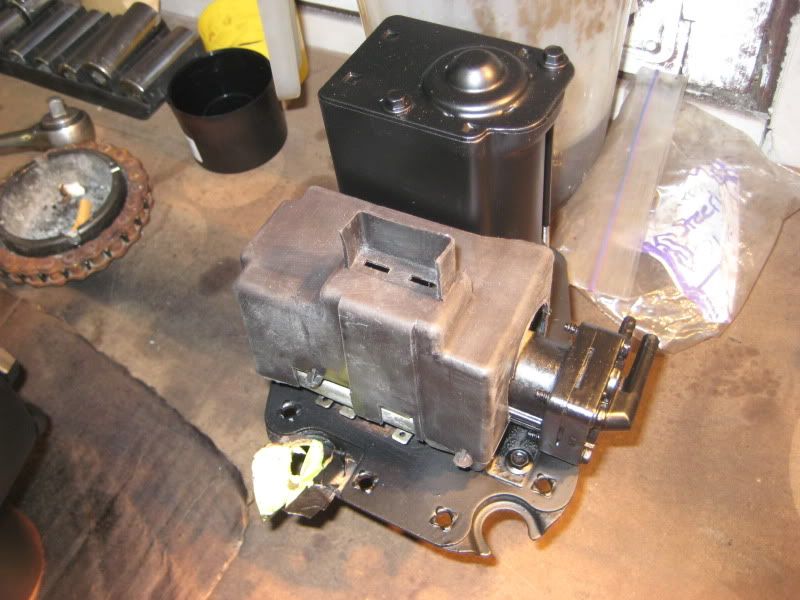

Seems like this setup is for a washer system yet my car never had any lines, hoses or washer reservoir. I may just put this back the way I originally had it, or buy the washer kit. But just want to confirm this has the pump and I could easily get the other parts needed OR can I somehow remove the pump mechanism and use this simply as a wiper motor, cause I may never need or use the windshield washing system.

Yes, that has the pump on it. Yes, it's removable if you don't want to use it. Yes, your car did leave the factory with a washer set up, someone probably removed it when it quit working.

part of the pump mechanism is missing, there is nowhere to hook the wires
2,265 Posts
part of the pump mechanism is missing, there is nowhere to hook the wires there should be 2 spade connectors sticking from the black cover

They are there, I just didn't push down the cover all the way .
Took a look at my original wiring harness and is has the connections for both the 2 terminal wiper motor and also the 3 terminal pump. I plan to install it as it is and leave it alone. maybe down the road, hook up a washer system should I decide I need it and want to undertake a small project.
