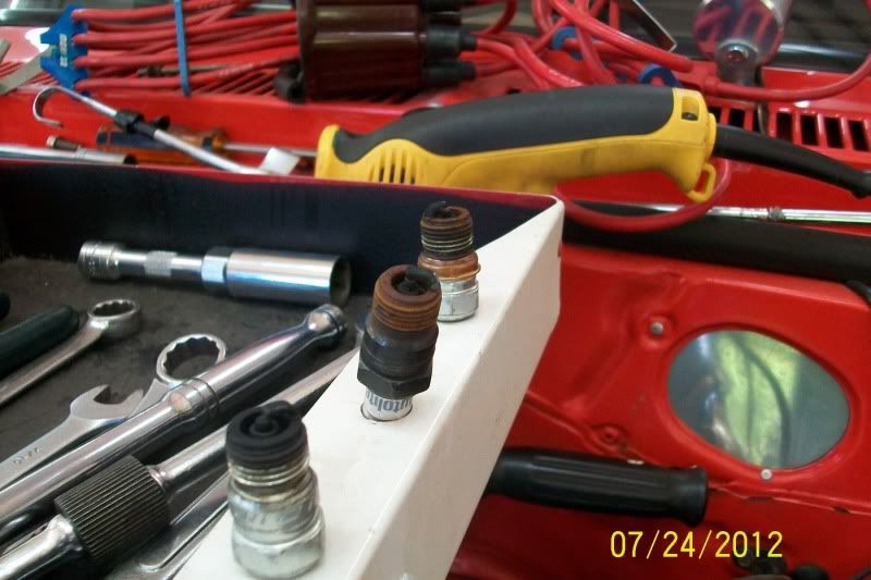

Here is a reason you should fog and engine then back the valve lash off so the valve close. This car was stored in a heated garage for about 6 yrs but condensation creeps into everything anyways. Look at the plugs inside

Lightly misting some light grade oil or ATF thru the carb while running and then taking out the spark plugs and shooting some in there as well while turning over engine.
It's been a long time, but I remember seeing some pieces that screw into the spark plug holes and they would absorb moisture. I believe they also had green-red indicators to show when to change. Don't even know if they still make them or not.

Fogging a motor is putting oil down the carb so the cyl and runners get oiled up. They actually make fogging oil for outboard motors to store them. Then if you back the lash off and close the valves nothing can get inside to mess things up much.

I checked all the valve springs on the right side of the motor and they are all between 210 and 240 on the seat. I would think that is probably about where they should be for this motor so being open 6 yrs hasn't hurt them apparently. But I bet the cast intake seats ain't happy.....LOL.

Those probably being a good brand of spring. I doubt some cheapies or old stock ones would have held up as good.
