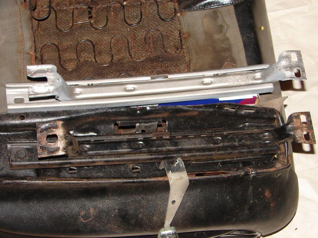

Got two sets of bucket seat tracks.
Not sure which is correct for my '67.
They are both the correct 14.25" or 14.50" floor mount spacing.
However, the front mount is different.
One pair has a split front hole and the other pair has a solid hole.
Need to know which one is right before I get rid of one pair.
Thanks, PartsCar.
11 Posts
Discussion Starter · #4 ·
Seat Tracks
Definitely not cut up tracks. :no: On the cross section of the angled area, I can see the shear cut where the upper and lower dies stamped out the metal. Not a jagged cut like with a saw. All four tracks are cut the same way and have identical impressions around the angled area.
The slot hole tracks were on a set of 1966 seats and the solid hole tracks were on a set of 1967 seats. Not sure if they were changed out at some point in their life.
Just trying to confirm the originality of the tracks.
Guess no one would actually walk by the car and say “hey, you have the wrong seat tracks”, right.
66 Posts
seat tracks
I will let you know what I know the track that is silver in color fits on a 65 bucket seat car and the other looks like it is for a bench seat car. The split is on my 65 bucket seats that are original for my car.
