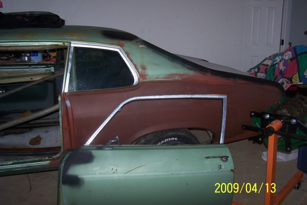

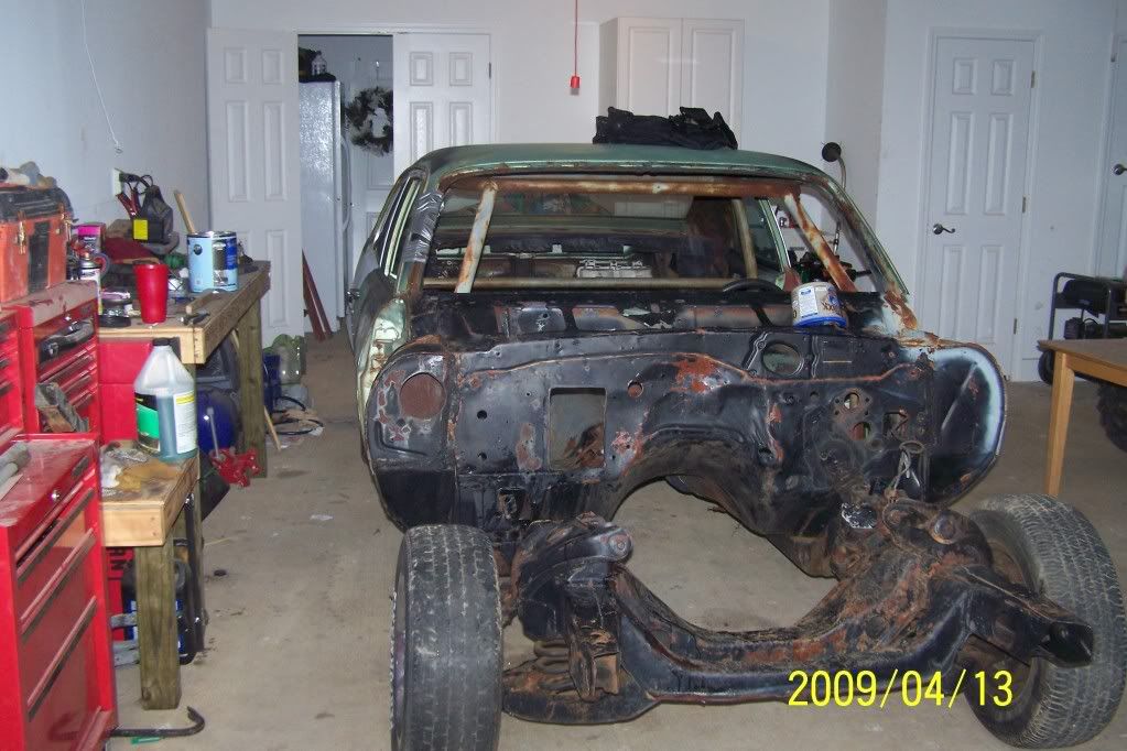

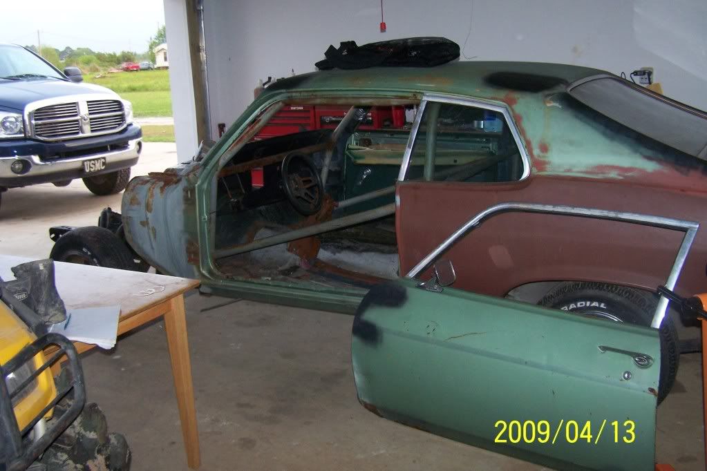

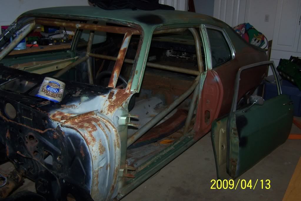

Well I picked up this 73 and it needs so much I don't even know wher to start. I've never taken on a project of this caliber, so I'll need some guidance, tips, advice, etc. What I'm aiming to do is have a nice street/strip car. Leaning more toward street with weekend runs down the at the track. Like I said, this is my first project like this. I don't want to Let someone else build it for me. I want the satisfaction of doing it myself. No timeline, no budget set. Just plan on taking my time and dealing with money as I come to it.
Thanks. and let me know what you think.

First step would be to evaluate the structural integrity of the body and frame...everything you will do starts from that foundation. I notice the car has a rollbar/cage setup...do you plan to keep that or eliminate?? for a street car with occasional track time...it realy won't help.
Next, try to plan what parts you need for the driveline..engine, trans, rear. Knowing what kind of engine and power level will help in choosing suspension, cooling and exhaust system components. You can do this planning while you are working on the body.
Do you have an interior for the car..?? It may not seem like a big item, but re-creating a complete interior from scratch is time consuming and expensive.
These thoughts should get you started....others will chime in with more words of wisdom.

I agree 100% Start with the structure. Make a list of what needs to be done, and parts needed and go from there. With out a solid structure you have nothing. If your structure is not solid, then you need to make it solid,Floor pans is where I would start, if there solid move to the outer body Etc. Good Luck with your project. Ask a lot of questions as you progress if you need to:yes: lots of people here will help you out.

Structurally, the car is solid. There are holes in the floor where they welded the roll cage in. Which I plan on taking out. I've got a 350 block in my garage and a th350 tranny. Plan on stroking the block to a 383. There is no interior at all for the car. No fuel tank. needs all new brake lines and it has drum brakes but I think I'll go ahead and put discs on. Should I remove the body and start with the frame(painting, new bushings etc) since it's allready tore down most of the way? I really don't even know where to begin with the interior and front end. Not really concerned with making it look like factory(interior), Just fuctional and nice and get the best bang for my buck. Thanks guys.

As has been said, start with a PLAN. from the sound of what you are looking at and what you want to do (above) you may want to re-think taking out the cage. If you remove a portion of it, say the halo and fron down tubes that restrict your forward vision, you can leave a nice 6-piont that will help with structural integrity. I would guess that the car already has sub-fram connectors, make sure your body bushings are in good shape and you are sitting alot better than most when they start. Especially if you are planning for a stroker moter, torque will find body flex very quickly.
