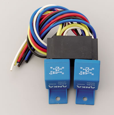

Here are the relays I used. Bosch # 0 332 002 150 About $20 online Google the part number for many sources.
And this VIA-80238 $8 from summit racing. It makes for a cleaner install and is cheap You have to reconfigure the wiring in the connector but that is easy as pie if you have a small flathead screw driver.
