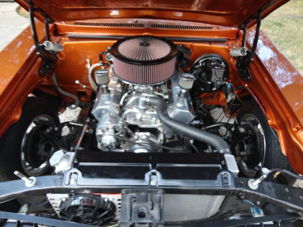

I am thinking of going to QA1 coil-overs in the front and was what was so of the coil weight rating are you guys running?
383 sbc
alum. heads
no wheel wells
inner bumper is gone and shocks
no heater box firewall shaved
