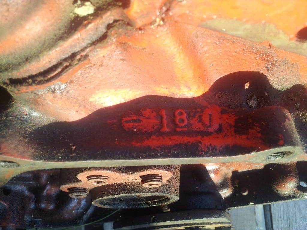

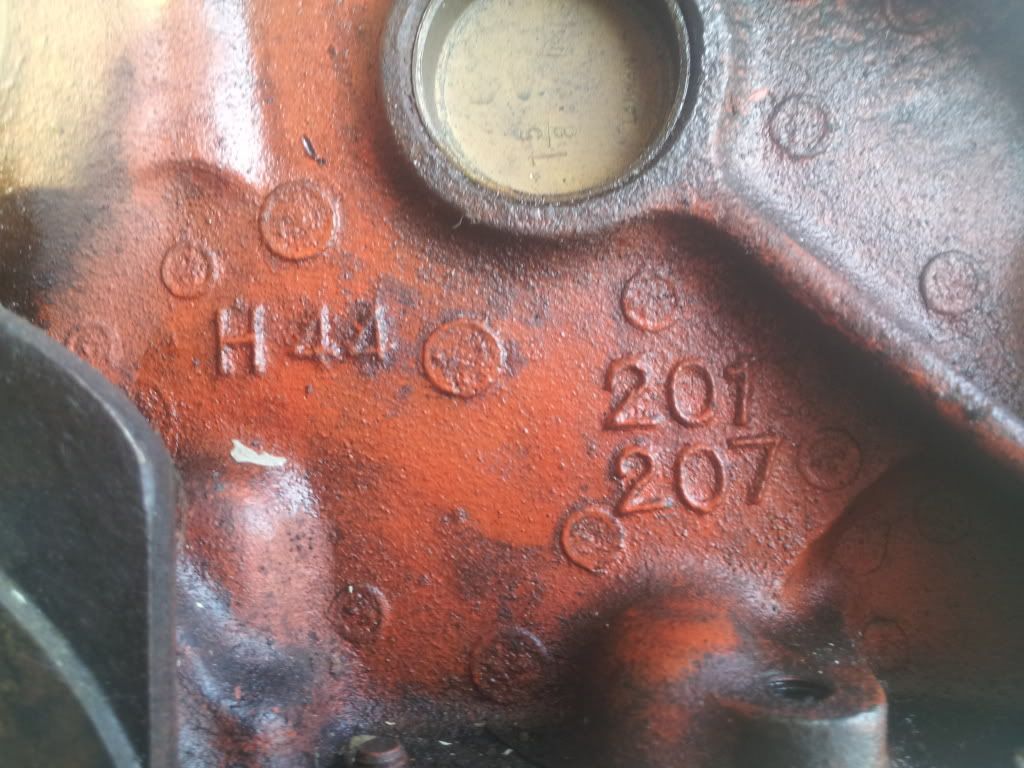

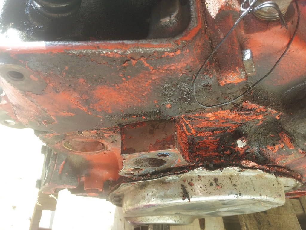

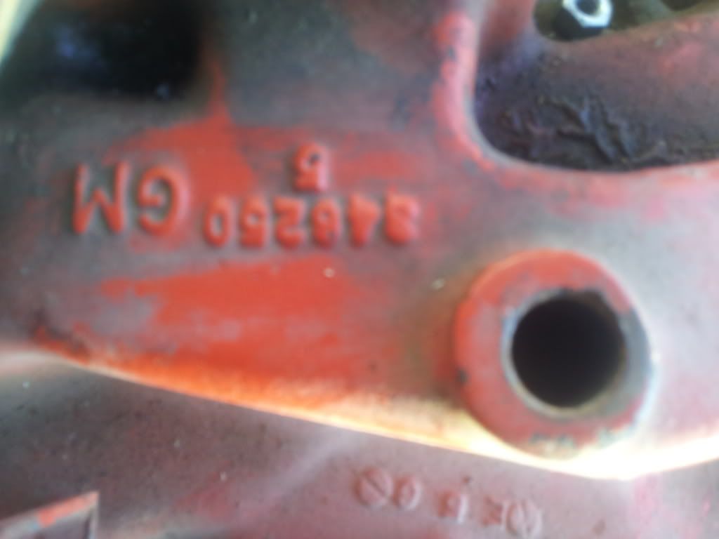

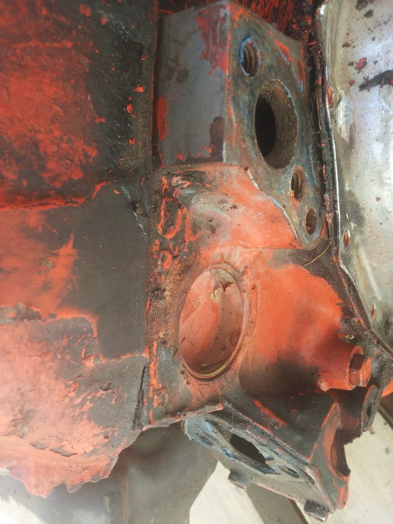

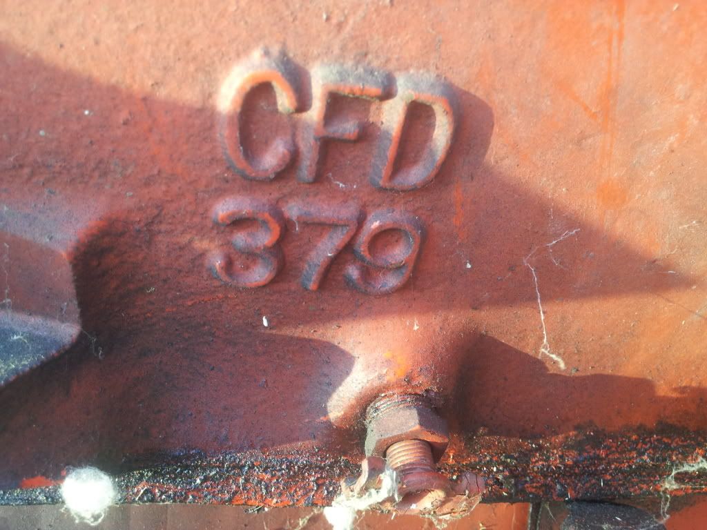

Can you guys help me identify a motor I just got? I was told it is a 350 but not sure what its out of ect. I am having a hard time finding the engine pad with the VIN ( I am a total rookie when it comes to all things cars) here are the photos I was able to find. Its either A. I have no idea what I am doing ( pretty damn good possibility) or B. someone shaved off the pad ( look at the last 2 photos)

How can I tell for sure? Just want ta make sure its a 350 as some on another site think it it may be a 305

how can I find the VIN on this guy? normally its on the engine pad on the pass side but as you can see its not here.. thoughts?
5,681 Posts
or has someone redecked the surface meaning by a rebuild...:confused:
thats the only idea i can get if you can not find it ....
1,241 Posts

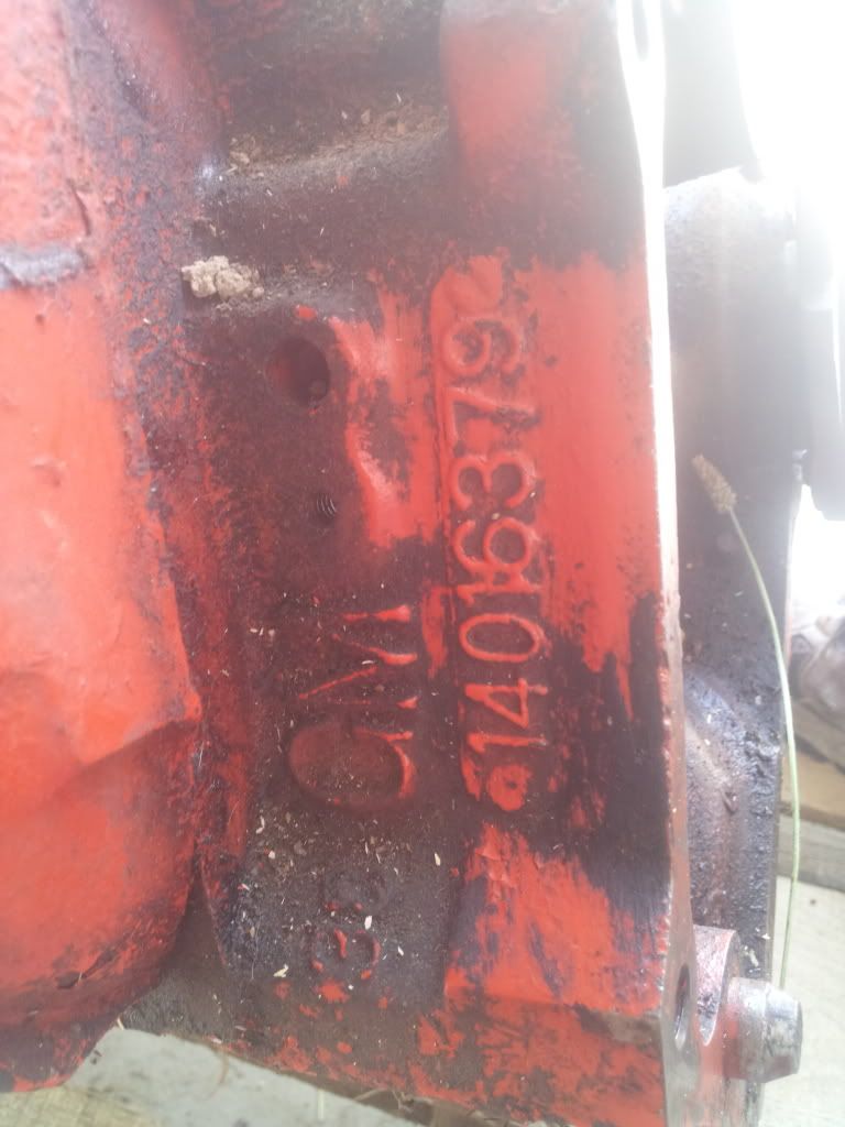

The 14016379 number is all you need to know. That is the ID for this block.
Outside of that pull the pan and check to see if it's a 4 bolt main. If so it is a few hp more than its 2 bolt cousin.
But it's not a 305, so you have something good to work with.
