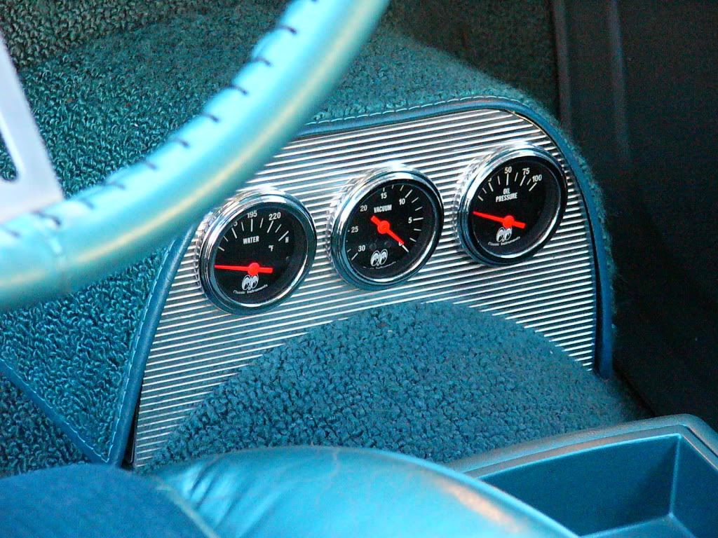

Cluster looks very nice! I really like that look...and my interior is the same color. So where did you get the material which you placed the gauges into?
372 Posts
I bought the material from an aluminum supplier in Seattle. Their name is Alaska Copper and Brass. Unfortunately, they now have a $100.00 min order. However I do have an extra piece that measures 12x8x3/8". I also have some extra carpet that I bought from Auto Custom Carpets. PM me if you are interested.
