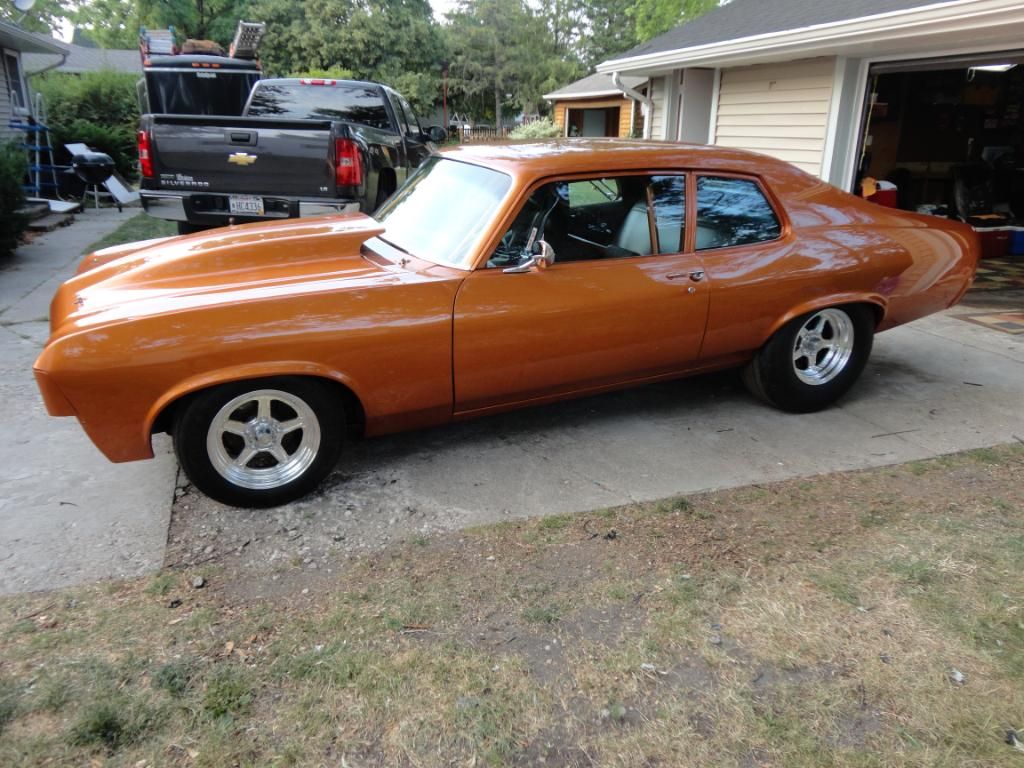

I want to upgrade the steering on my 73 whats the best way to do that? I was thinking of putting rack n pinion on there i already have tub a-arms. Is there a such thing as a bolt-in power rack n pinion for my car.

Im not really looking for better cornering just tighter steering less play better reaction. will just buying a new steering box make that big of a diifferace?

I have a little bite but not much and the box is orginal and the hose that were on it were pretty bad so i bought new ones and were you screw in the pressure side the treads are gone so bad that the 1 side is completly smooth so thats what i got going on so i figured that was the last old thing left on the car so i figured that rack n pinion was the way to go but if i can get a little better steering with just buying the steering box then why not go with the upgraded box.
