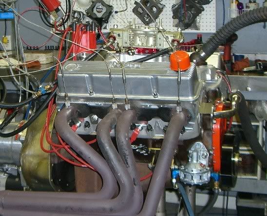

I had the same problem your having with my valve covers. I tried those rubber gourment things and my PVC still sucked oil and made a mess of things. So here is what I did to fix my problem if you running roller rocker.
Here is some pictures:
The top photo shows the shield I built it out of 16ga. sheet metal as you can see i built it the same lenght as the rockers and the same width with some bends on the top and bottom to stiffen it up and then had to make a few alteration to get them to fit.
The sec. photo shows how I mounted them. I took the ori. set screw out of the 2 rockers 1 in from each end of poly-lock and installed a 1 1/2" long set screw to lock the poly-lock and hold the shield. I adj. the rocker and lock it all down then put a fine thread nut on the extra long set screw for a spacer for the shield just finger tight put the shield on and put a nut alnd lock on the top. Done no more mess and oil being sucker throught the PVC. You can check more photo's from the link below. Hope this helps you!!!
