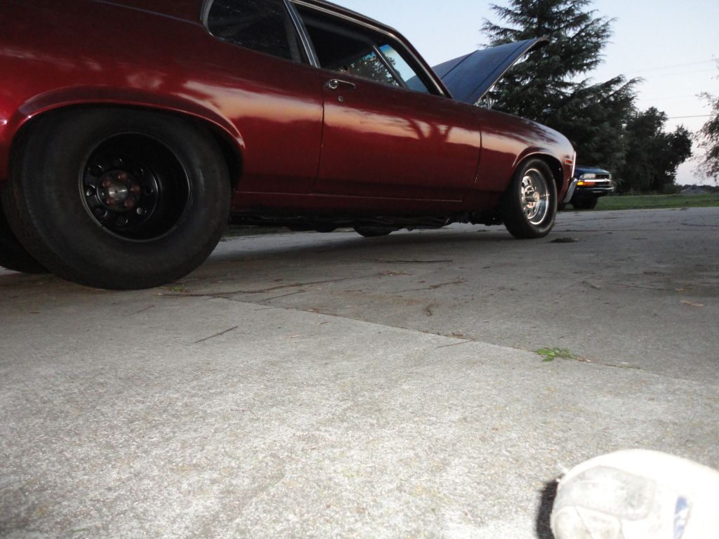

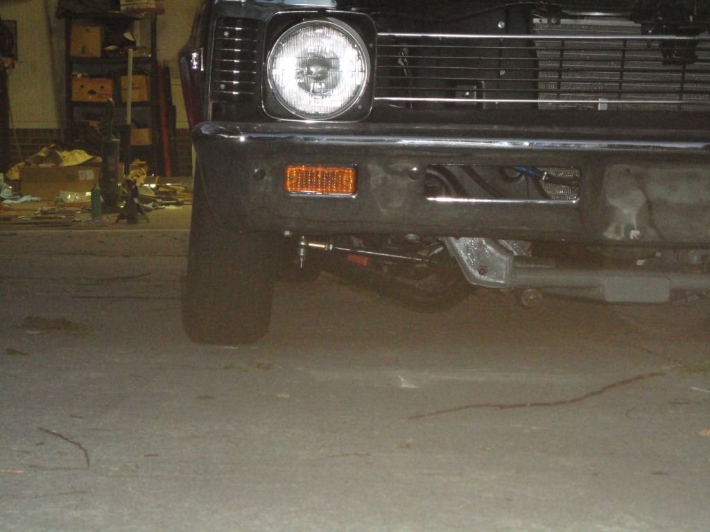

Im a little worried about the negative camber that i have. It measure between 4-5 degrees on each side. Also, the car seems to sit lower, but this could be due to worn out springs b/c the springs came with the car and i dont know the history behind them (could be the stock ones for all i know). See pics below that i took last night. There is no adjustment for shims to push the upper control arm out (toward fenders) which seems like would alleviate this camber problem. The shims seem like they would be put on the other side of the shock tower/bracket which would bring the upper c.a. towards the engine, and cause even more negative camber.
What are yalls thoughts on this?
Also, the lowest point of my car is now the lower control arms, which are a little less than 3 inches from the ground (i can barely get my closed fist in between the lower c.a. and the ground). This is a drag car, so i may be ok, just need to make sure they dont slam down and hit the ground.

I looked through your pics in your signature, and didnt see a pic from the front head on. Does yours have this much negative camber as well?
Slow Nova,
I have 1 degree of negative camber. Looks like you have much more :yes:

an alignment wont help. as mentioned above, shims will only make it worse. after some research, it looks like i need an offset cross shaft, to allow the upper control arm to move towards the fenders, and give me less negative camber. See the pic below of my current cross shaft, with all the shims removed:
Im wondering if This Global West Offset Cross Shaft will provide me with enough, b/c it states that it will give about 1-1/4 degree gain, but im at about 4 degrees, and this wont be enough.

But, i just realized that i was measuring the camber with the removable crossmember (under the oil pan) not bolted in place. Afer looking closer, it looked like both frame rails were twisting towards the engine, probably due to the weight of the engine with no support underneath. I jacked the car up, bolted it in, and now im sitting at 3 degrees negative camber, instead of 5.
I think a combination of 2 things will get me to 0 degrees.
1. An offset cross shaft. From what i read, the offset cross shaft is good for almost 2 degrees.
2. new springs (mine are worn out and/or have a coil cut out). This will likely give me the remainig 1 degree, b/c i notice as i jack the car up and the control arms begin to droop, i gain 2 degrees at full droop, indicating the camber gets positive as the springs get "taller", just as TomM mentioned
