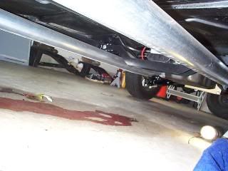

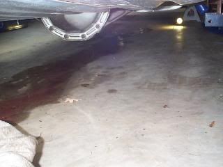

Any suggestions on how to stop a trans fluid leaking from the driveshaft yoke.
I don't think it leaks when driving (there is a minimal amount of fluid just above the front U joint from rotation) but once it sits in the garage I get a constant drip of trans fluid from the back of the yoke.
Any ideas will be greatly appreciated:yes:

I had the same thing happen. Your yoke probably has a small hole in the center of the yoke. You will not know it is there unless you take the shaft out and look down the center. You will have to take the yoke off the driveshaft and find another yoke.
OR...
There are some yokes that have a small disc that is concaved that will fit in a little spot at the back of the yoke. This hole will allow just enough fluid to leak all over the place. Ask me how I know.
You can put some sealant in the small hole or place the disc over it or replace the yoke but you must close off this hole. I replaced the rear seal, checked my speedo hole, all that. Still leaked. I searched for a week and then found this hole. Found a disc that goes in there, epoxyed it in there. Some yokes on truck transmissions had this hole. I assume for ventilation but others told me it was always plugged or covered by the disc I mentioned. Replacing the disc fixed my problem immediately and permanently.
