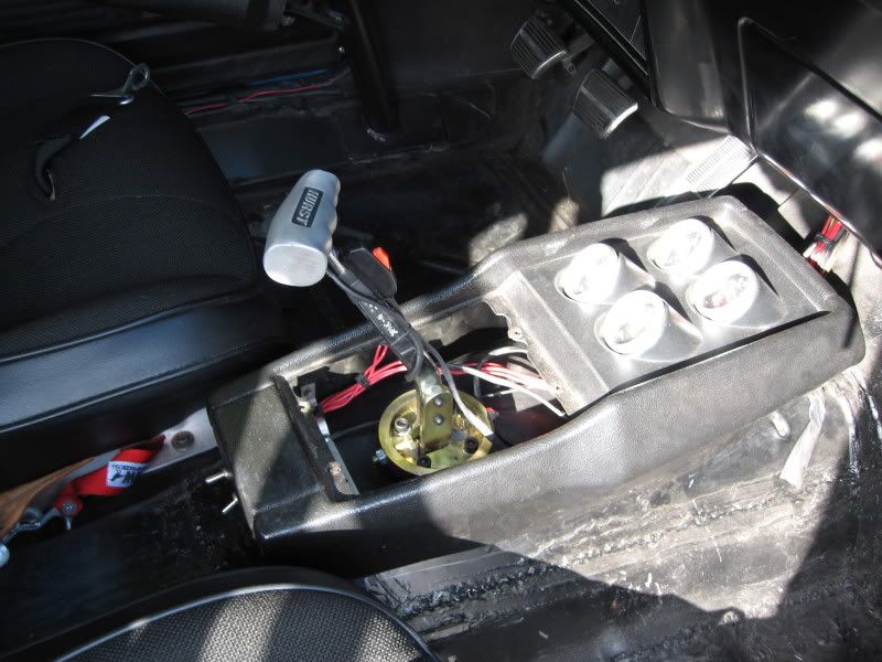

Not much to see in terms of pics. That's what sucks. Tons of $ and it looks about the same. Here's the new shifter (same arm) as well as how I modified my scatter shield.

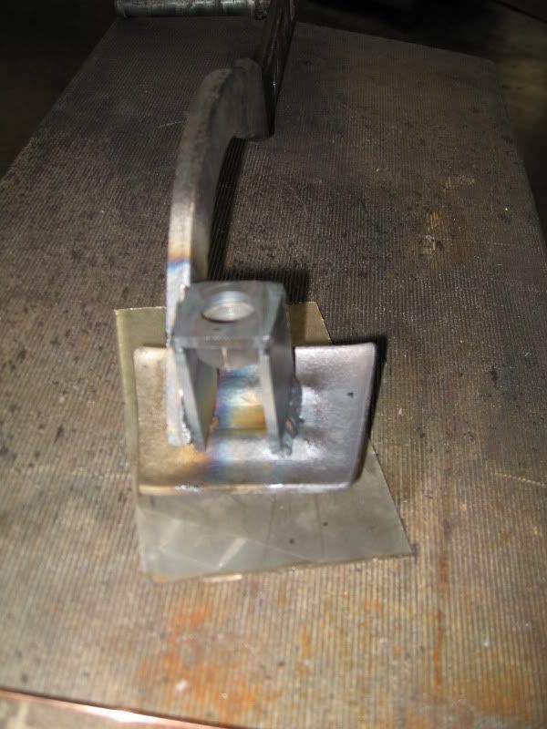

Put a clutch pedal stop in. Now it's a LOT more predictable to drive. Don't know if it'll help my 60', but it had better help me shift a little quicker.
The bolt is longer now actually and stops against a 1/8" plate welded to the floor
