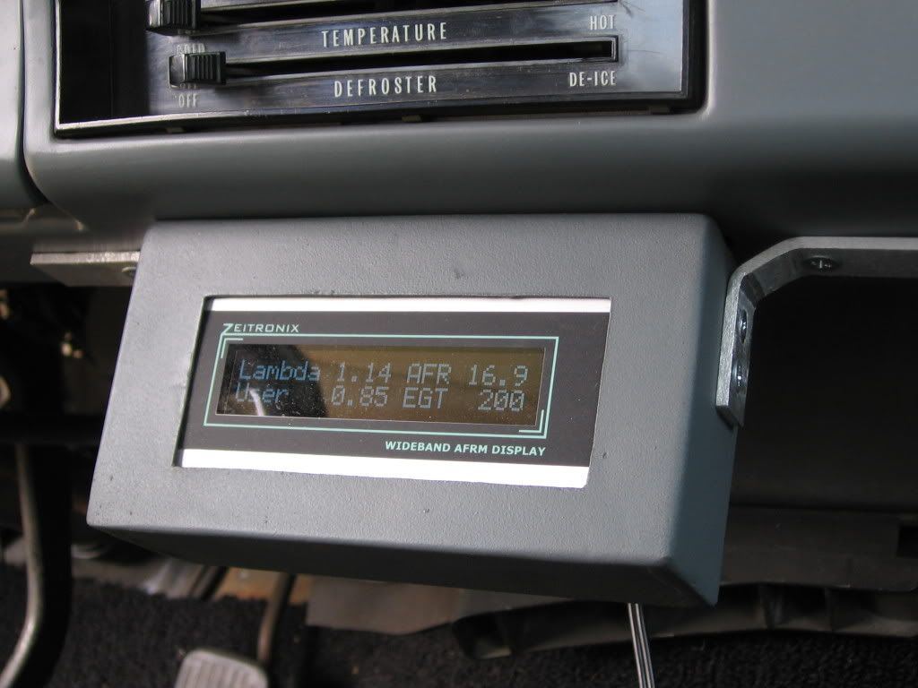

Wideband would be nice, but wont be doing that anytime soon. Vacuum gauge is it for me for now, haha!
