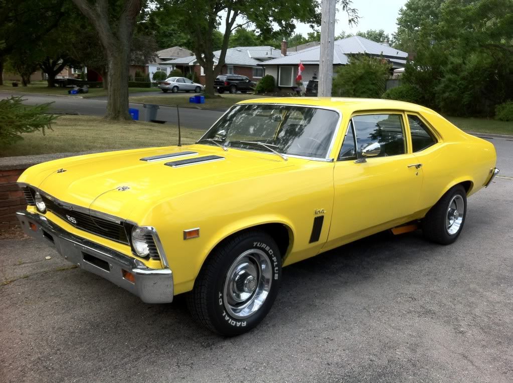

I've been wanting a classic car for years and the 3rd gen novas have always been in my top 3 'wants' so when I came across one that appeared to need a little tlc but was still in a drive-able state (PO had it plated and on the road) I picked it up.
Lo and behold there were a few more issues than I was expecting. That being said I'm committed now to getting this car to the picture I have in my head.
As you can see car looks decent on the outside, couple of rough spots here and there.
The floor had been patched, and badly, in the past so I pulled the interior with the intention of cutting out the old patches and having some proper panels welded in. Talk about an eye opener, floor areas have more rust than metal and the drivers side seat brace is rusted out and it looks like was only being held on by rivets through rusted metal :eek:
On top of that, the trunk the inside of the trunk was covered in duct tape and then painted over to hide any rust holes :mad:
And last (I hope) when checking under the trunk it turns out one of the traction bars is broken right in half, so they're going to have to come out. I was intending on replacing the rear leafs at some point anyway, so this just means they get done sooner.
I'm now dubbing this car 'The Nightmare' but, strange as it sounds, I'm still looking forward to 'saving' this old beast.

Wow, you have some work ahead of you, it looks like a typical Ontario car though!:rolleyes:
I like it more then the bike!:devil:
crazy what pictures don't show, looking at the first pic the car looks amazing, but whats hidden isn't so pretty :no: good luck with everything :yes:
