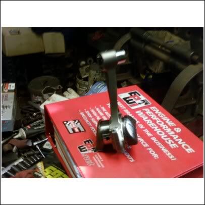

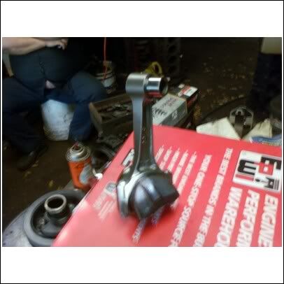

I went over to my engine builder's shop today and seen this. Talk about some major damage. This came out of a Late model dirt car. The funny thing is the guy was only on the warm up lap and was only at 3500 rpm's when this happen. That is a GM steel crank with some crower 5.7 rod's. The only thing that they "THINK" it might be is the crank has been in this motor since 2000'.

I have had that with a stock crank. Seven years in the cradle, and she broke in two places. Now I'm using aftermarket for a good reason!

Yea me to that is why I bought a Lunati Pro series crank. This one was in a late model dirt car and was over 9 year's old.

that's good to know...in other words a well built motor with a stock crank is more than adequate for the average street strip car!
ABSOLUTELY!!! In fact we run stock cranks in many of our 10-11 second drag strip only motors. They are not ideal once you start pushing some serious horsepower, but just fine for mild stuff especially under 6500 RPM's.

Crank shaft thats been roundy round racing for 8 season's.:eek:
You can not blame the crank! :no:

Yea that C/rod is bent in 5 different places and did not break. Oh those are some corillo(SP)rod's 5.7 to be exact. they are forged not billet
