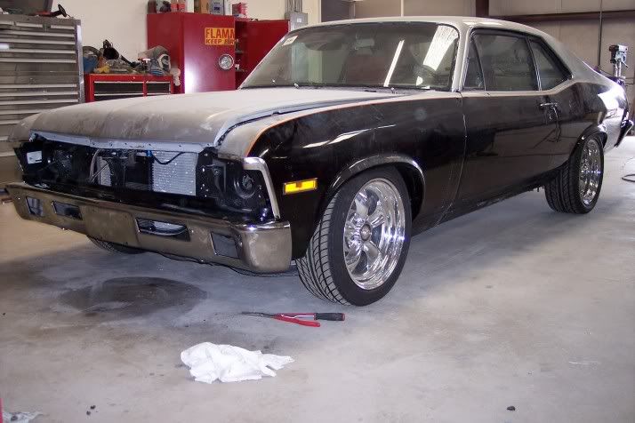

well finally getting the front end on, aftermarket chrome trim sucks..if i had to do it again i would have repaired the bezels i had..my headlamp bezels are in paint i got some bumper brackets and lights from another member..man this pays off..

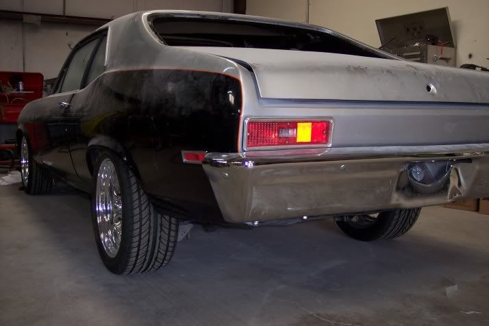

ill have the back glass in next week when i get the package tray and the two trim pieces ( from another member)..lol
WITH OUT THIS SITE MY NOVA WOULD BE GETTING DUSTYER AND DUSTYER..THX TO THAT HAVE PITCHED IN!!!:beer:

the suspension: 2" dropped spindles, hotchkis lowered springs in front and rear
rims: american tq's 17x7 front 4" bsp, rear 17x8 with 4.75" bsp
tires: falken's front 215/50, rear 275/40..
i had my car on the rack and noticed i have 1.5"-2" more room between backside of the tire and the frame rail.. maybe a 17x9 with 5" bsp and a 295 tire is in the near future
thanks again
