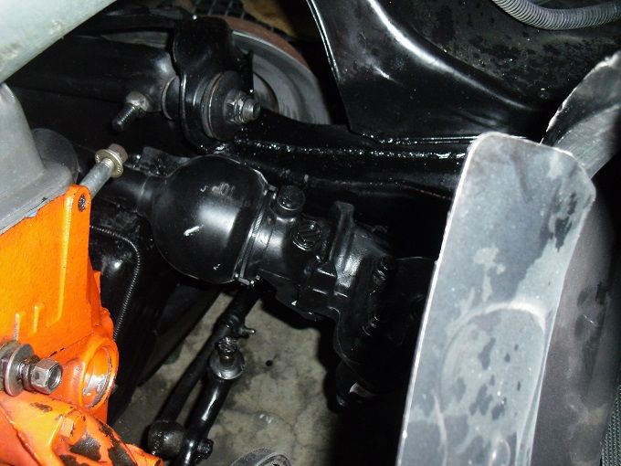

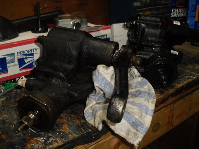

I have been wanting better steering feel so I did some research and ordered a 1986 Monte Carlo SS rebuilt steering box and power steering pump. What I have learned is that there are 2 4th Gen Nova sizes of steering shaft 3/4" with 25 spline + flat spot and 13/16" with 31 spline... The 3/4" size is the newer size they started going to in 77 I think. Mine is the 3/4" size which is the same as the Monte Carlo box. It should be a little quicker ratio and hopefully better road feel.
Old Box
New Box installed
I am also going to replace my sway bar and end link bushings with poly ones as well as the control arm bump stops which are either broken or missing. MORE LATER

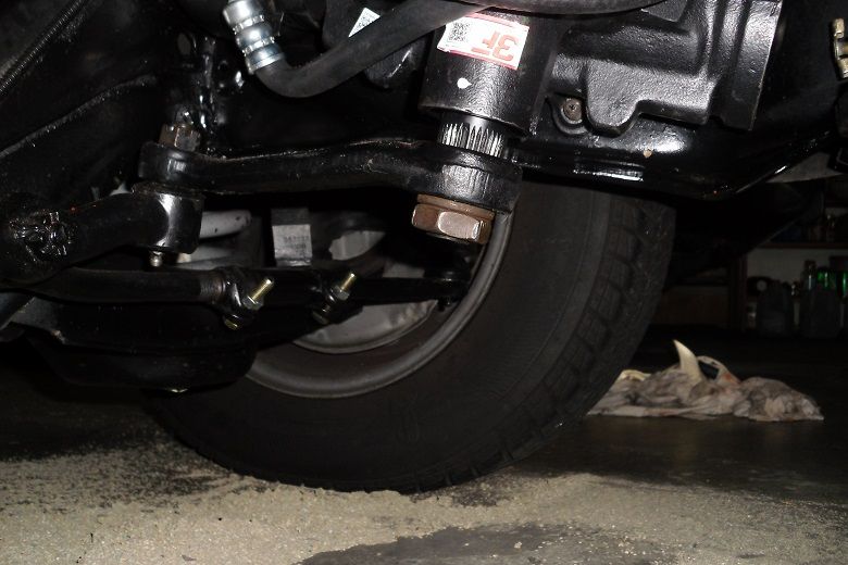

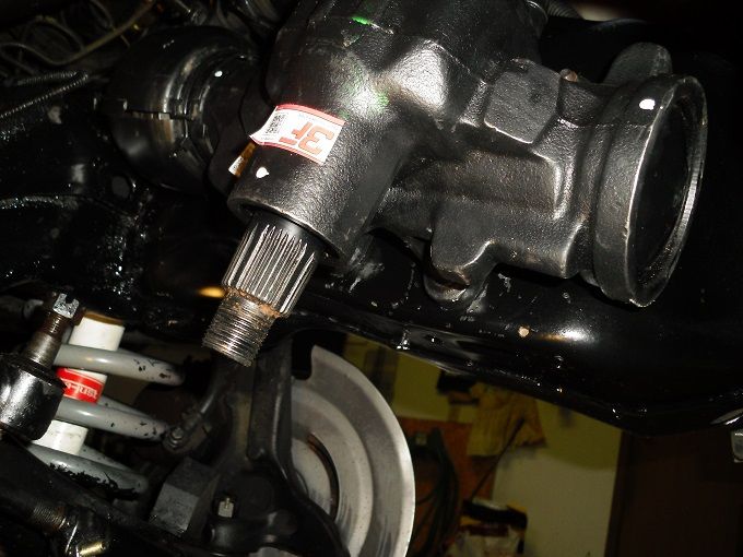

Was wondering if anyone who switched to the Monte steering box had problems centering the steering? After installing mine and centering the steering wheel through the tie rods I noticed I have an unequal amount of turns left and right to the stops. Also can't seem to turn as sharp as the old box. There are only four mounting positions for the pitman arm and only clears the frame and reaches the center link. Did anyone change to a different pitman arm?
#14 ·
If you just ordered a box from a parts store, you may have gotten the Trans Am box. It is a quick ratio like the Monte box, but the sweep of the output shaft is less which would explain why you don't have the turning radius of your original.
I didn't have any problems centering the box I had. It sounds to me like you will need to adjust the tie rods to bring the tires to center when the box is also at center. A competent alignment shop will be able to do this if you need an alignment anyway. If you do it yourself, just make sure to use equal numbers of turns to each side or else you will need the shop anyway.
I used the original pitman arm on the Monte box. No clearance issues.

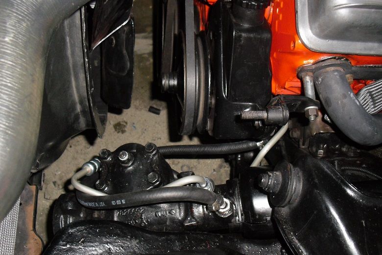

Next step is to install power steering pump. Pulley is on and I have a pressure hose. But I need a return hose and was thinking of using two of these that should fit the 86 Monte Carlo pump and box.
http://shop.advanceautoparts.com/we...063=1986+:+Chevrolet+:+Monte+Carlo+SS+:+5.0L+305CI+V8+Carb+VIN:+G&storeId=10151
I would connect them with power steering hose and clamps. The fittings come in different angles. Not sure which would work best yet. Any thoughts or suggestions?

For the return line I ran power steering hose from fitting that comes out of back of power steering pump to a fitting on steering box. Since there is no pressure I used hose clamps to secure. I got an o-ring type return line fitting for the steering box off a late 80's Trans Am in a salvage yard. The return line cost about $5 total for hose and fitting.
Hopes this helps at least a little.
