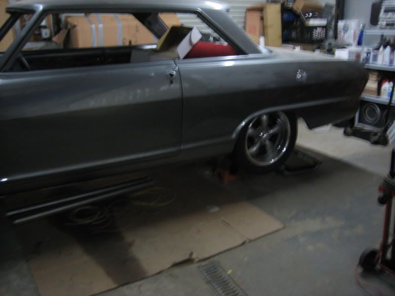

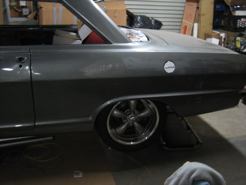

got rubber mounted up
245/45/17 17x8 41/2 bs fits perfect

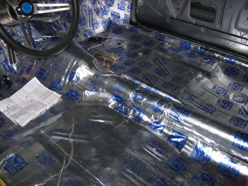

fat mat insulation down
started running my new e-z 21 circuit harness
so far pretty smooth

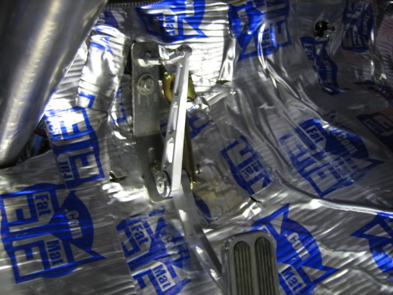

lokar gas pedal assy (modifed)

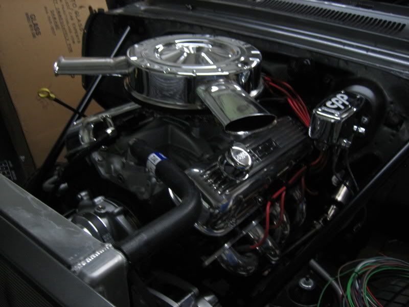

added a few more things to motor,
ignition wires, alternator, mounted up rad support and radiator , started fitting hoses with the big block
210 Posts
Thanks, Your car looks fantastic! I'm waiting for my wheels to arrive this week, can wait! I went with a 17x7, 4in BS up front and thinking of a 225/45/17 but now I'm thinking with going with the 215's, with the TCI clip up front. On the rear,17x7 with a 3.75 BS, 235/50/17, Ford 9in rear with leafs and 1in narrower that stock. Was thinking of 17x8 but did not want to chance in not working.
