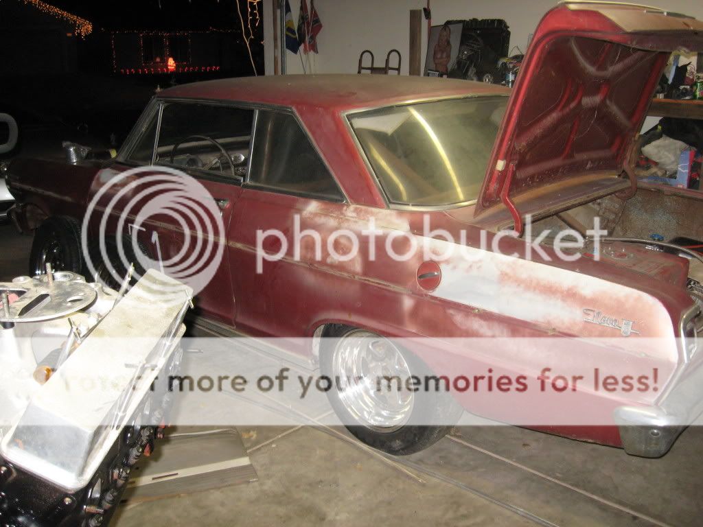

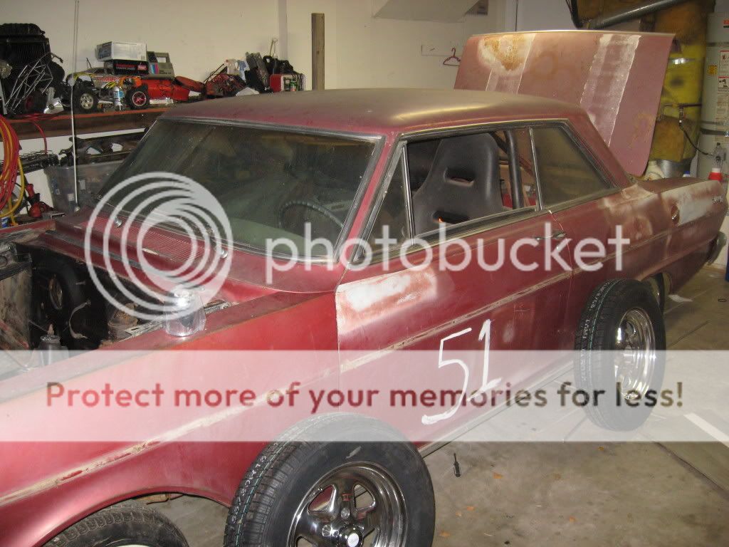

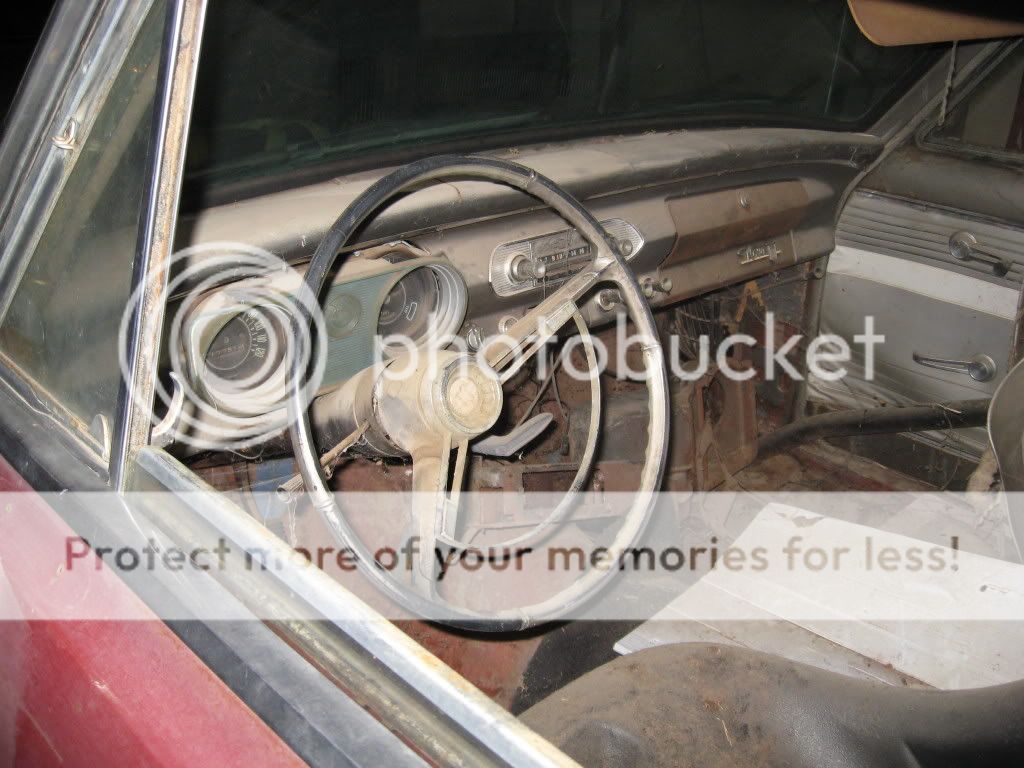

this is my fiances car that we are building together for her. i built a .60 over 327 with GM angle plug fullies and around 11.1 comp. comp hyd. cam .519 -.523 lift and 244 246 @50. it is backed by a th350 tranbrake trany and a 3500 stall. 9" in the rear with cal trac split leafs and cal trac bars to aid in the traction department. here are a few pics of hoe it sits now. the only mod to the car thus far is a six point cage we installed about two years ago.
