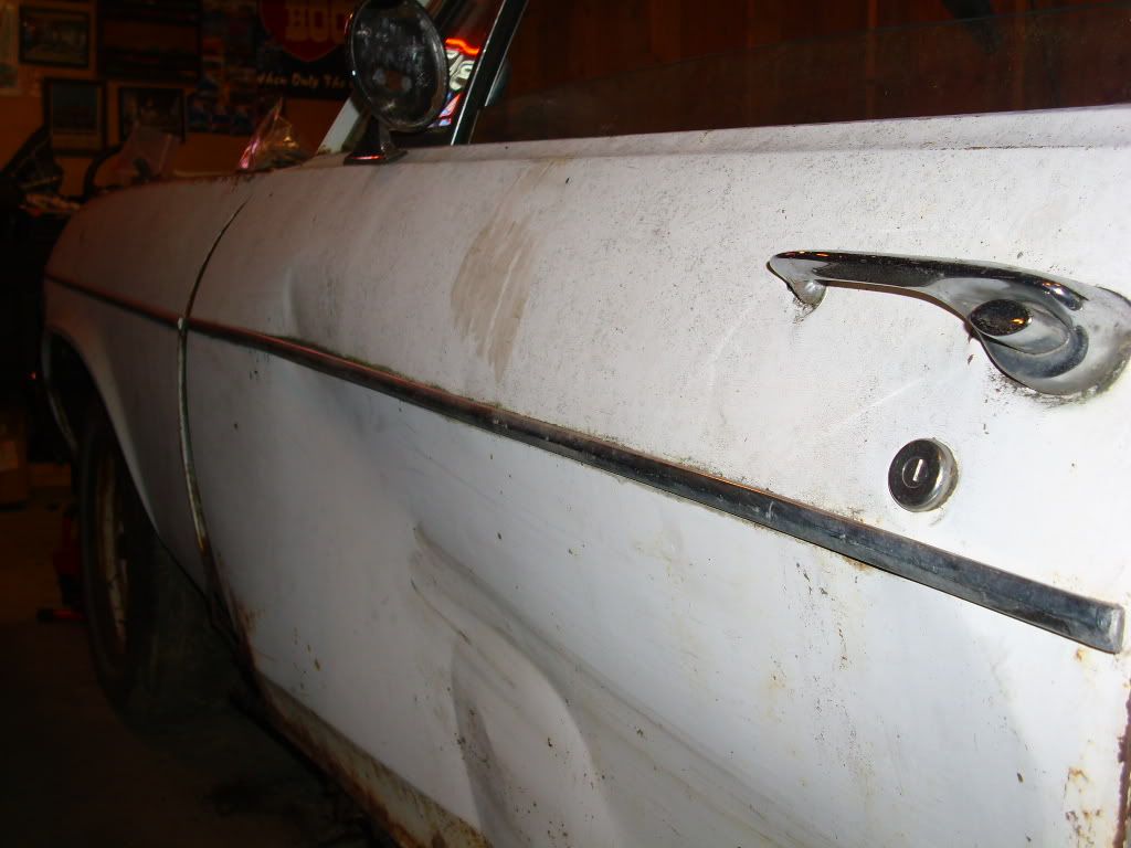

There should be speed nut at either end of the door undo them and slide the molding forward or backward about a 1/2" and it should come off.
2,112 Posts
After its off you have a lot of little tits sticking our of the body. Clip...grind...ding...fill...sand...prime...
Its a pain but looks nice when you're done.
Dave
16 Posts
And take your time...That is rare chicken lip 68 only trim.
so you're saying the side body trim is 68 only? or was there "special" trim on the 68s? my 68 has the trim, but i was considering removing it when the body work starts...have also considered keeping it cuz my garage can be a little tight and my daily driver's door does touch the nova (only the trim, of course) on occasion. if it's unique to only 68s, i'll think more strongly about keeping it...
Yes, it's different from the 69, so it a one year only item.:yes:
