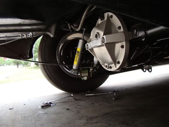

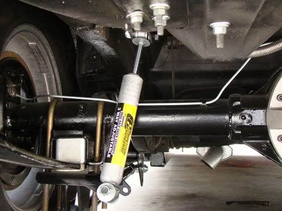

im having to remount my shocks because the caltrac mounts a little different then the traction bars I had before. I bolted up the bottom and just loosely laid the shock with the mounts against the shock bar. does this position look ok?

Is the base of the shock making contact with the tube on the rear? If not the angle seems fine to me. I was actually going to ask the same question, I was having problems with the clearance of the shocks on my Nova and I was wondering where the caltracs system relocates the rear shocks to. from the pics you provided it looks as if the shocks get mounted inboard more.

I think the rule is 15 degrees max. Also keep in mind as you move them in from standing straight up and down it does take away from the shock valving.

Thats close to what I have. Works great except I need a smidge more travel in the shock.

You asking me? The rims I have are 5.5 offset and the tires rubbed the shocks. So it was buy new rims or move the shocks. Plus I would like to mini tub it at some point.

you have two eyes in the shock, if you mount the shock at an angle the bolt in the eye should go from the front to back of the car. When you compress or extend the shock it will change the angle slightly depending on amount of travel. having the eyes in that direction will let the shock lean or straighten out with travel.
If the shcok is mointed straight up and down then you can run the bolt side to side.
They shock will work either way, the shock controls the rate of seperation of the rearend. Its just better to not have bind in a car if you can

im trying to mount them straight but the caltrac mount is at an angle so it makes it kinda hard to do. is there any way to solve this?

by rotating the top to match the bottom it would avoid bind
As for problems i cant say that, but you have a rubber bushing in the top and the shock cant rotate/ piviot on the bolt, so it will side load the bushing binding it

You can weld a bracket to the cal trac plate to mount them that way. you can weld brackets on the housing that is the way my car is. ask aron69nova he has pics of my rearend.
All this depends on what style shock eye is on top also
