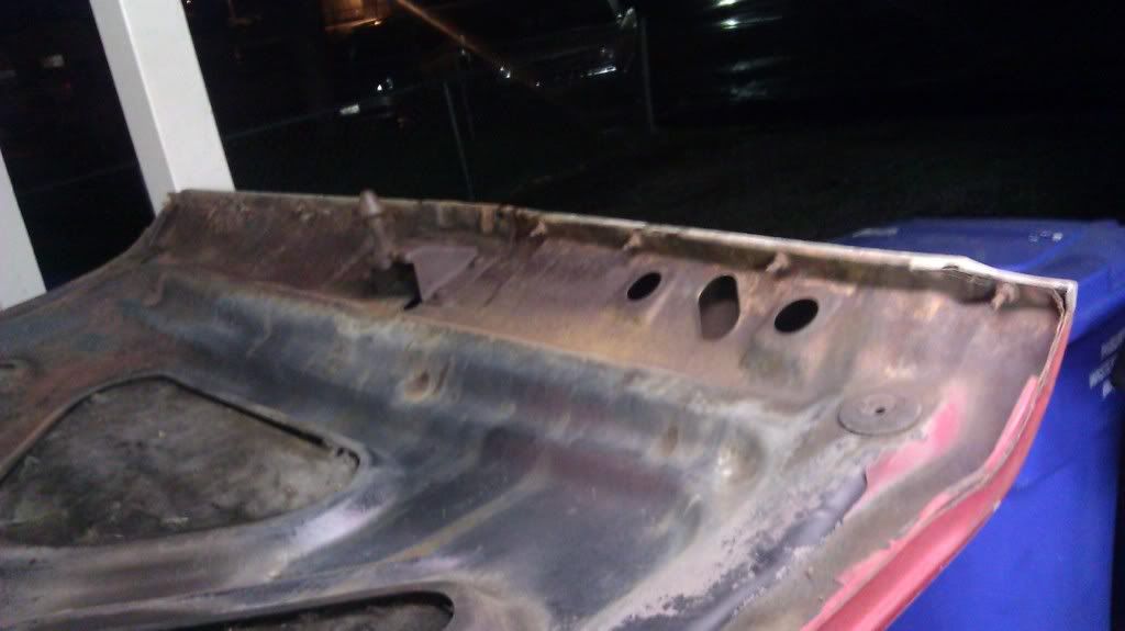

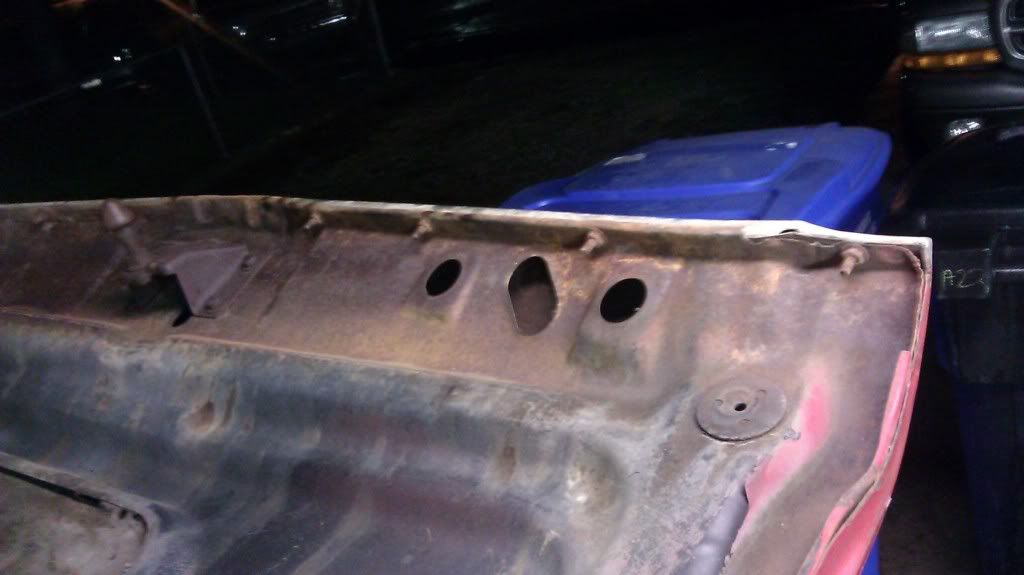

This is probably going to be my first post of many. But i bought this car and with lil to no money i am doing this on my own and am goin to need advice until the end. I have obvious clear coat issues but right now i pulled off the hood and im starting to work on that. First time dealing with this much rust so i need to be pointed in the right direction.
i am doing the bottom first and then top

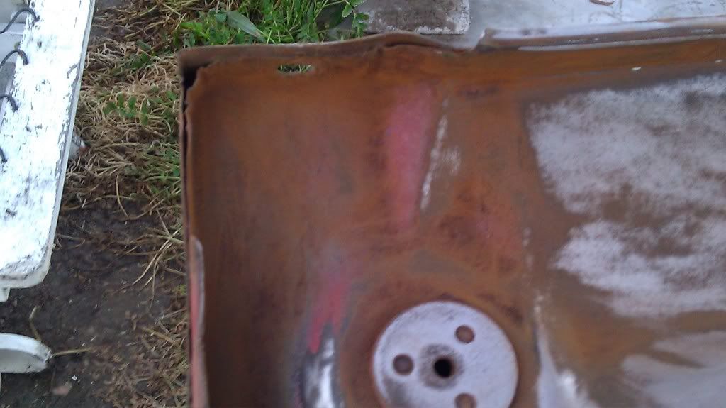

I worked on it for a small time today and was able to get to this but i am curious of the best way to get to rust in the hard to reach areas or is it just patience and a careful finger
Anything i can do with the rust? anything i can put on it to help me get it off? do i just need to keep sanding? or should i look into sand blasting? which i dont know much about or how expenses, any help would be appreciated

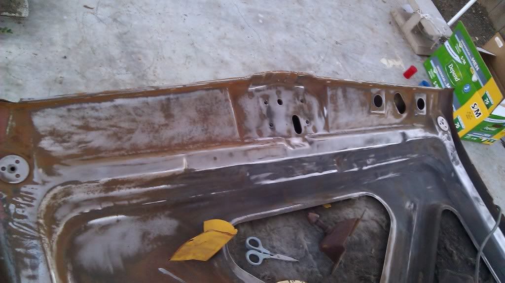

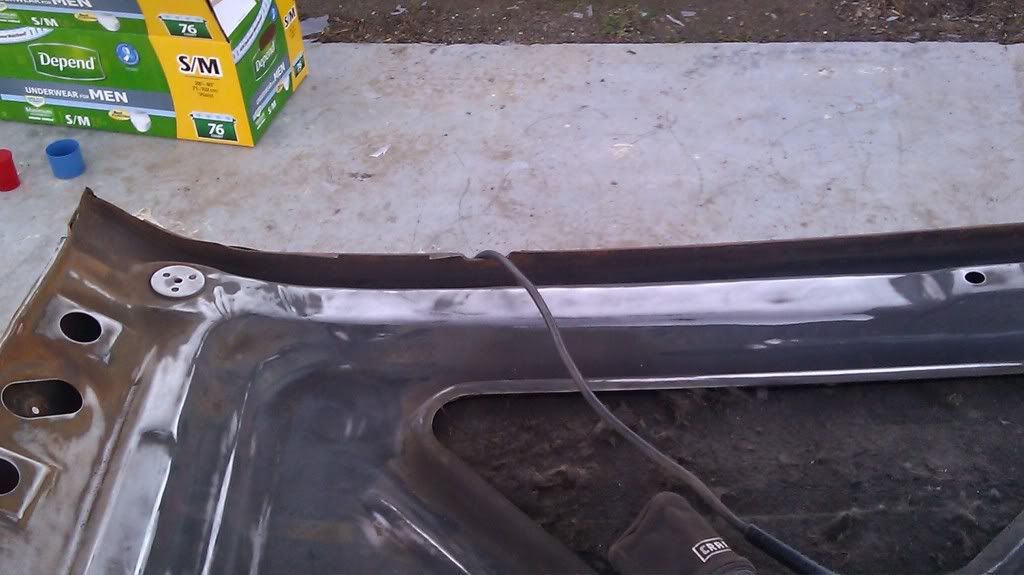

Well i was able to get my hands on a grinders and sanders and was able to get the rust off and it wasnt really as bad as i thought. Only took me a few hours and a sore back to get it off. Im doing this with lil to no money so any work i can do saves me in the long run. I appreciate everybody's help and i can already tell how how much help is out there at the hands of the members of this site. Looking forward to more posts...i have more rust where this comes from, like by the fenders...this sounds about right? i heard it was the most common place for the novas
