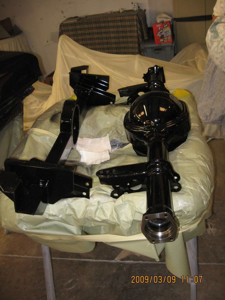

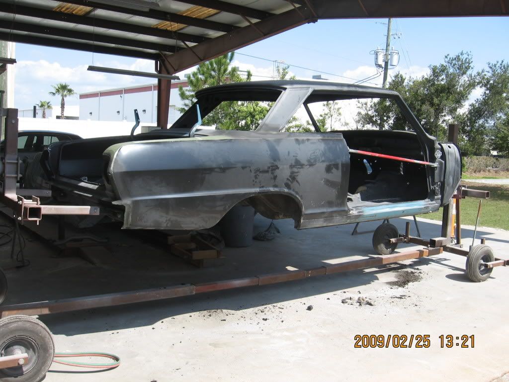

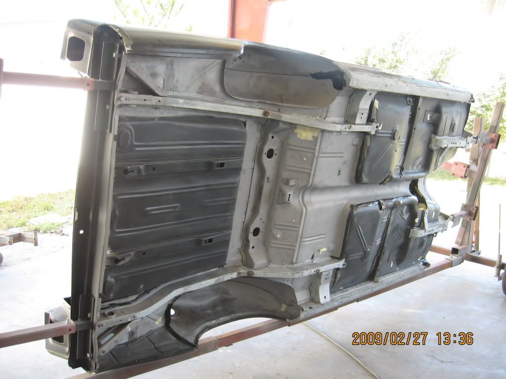

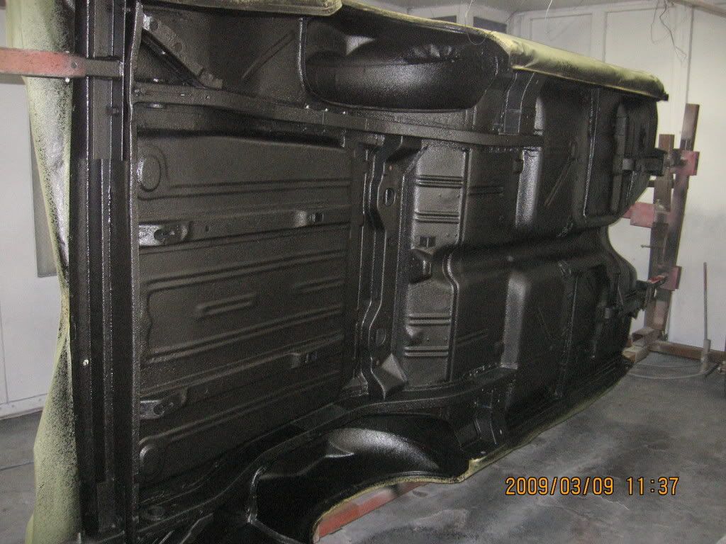

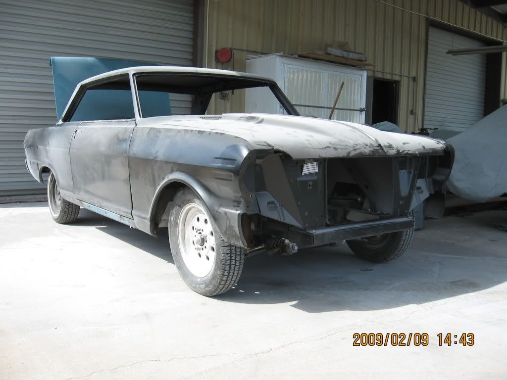

After a long hiatus, the body repairs have finally resumed on my '63 SS. The shop had some difficult times inc. the death of one of the owners, regrouped, and are back on the job. I'm glad I waited it out because their work is incredible. R qtr. has been installed, car was put on a rotissorie, the underside of the floor was media blasted and finished, sealed, and painted in epoxy primer. It was then coated with Wurth Stonguard, then painted in GM chassis black. I purchased a TCI 4 link with polished stainless 4 link bars and billet coilovers to go with the TCI front subframe. I also purchased a Dutchman Motorsports shortened 9" rearend. The subframes and differential were all painted in a high gloss black. Attached are the latest progress pictures.

Thanks...is was the shop's idea, but I'm really happy with the results. I understand this comes on the underside of some Mercedes's and BMW's, its very durable, and you can paint over it. Thought of using Lizard Skin or Line-X, but I think this was the best choice.

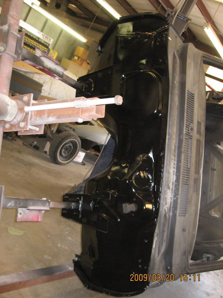

This week they installed the TCI 4 link...man I love how it looks! Also are hanging the front TCI subframe , then will put it back on the ground. The body gaps have already been done with all the new panels, now the body work and block sanding starts.
