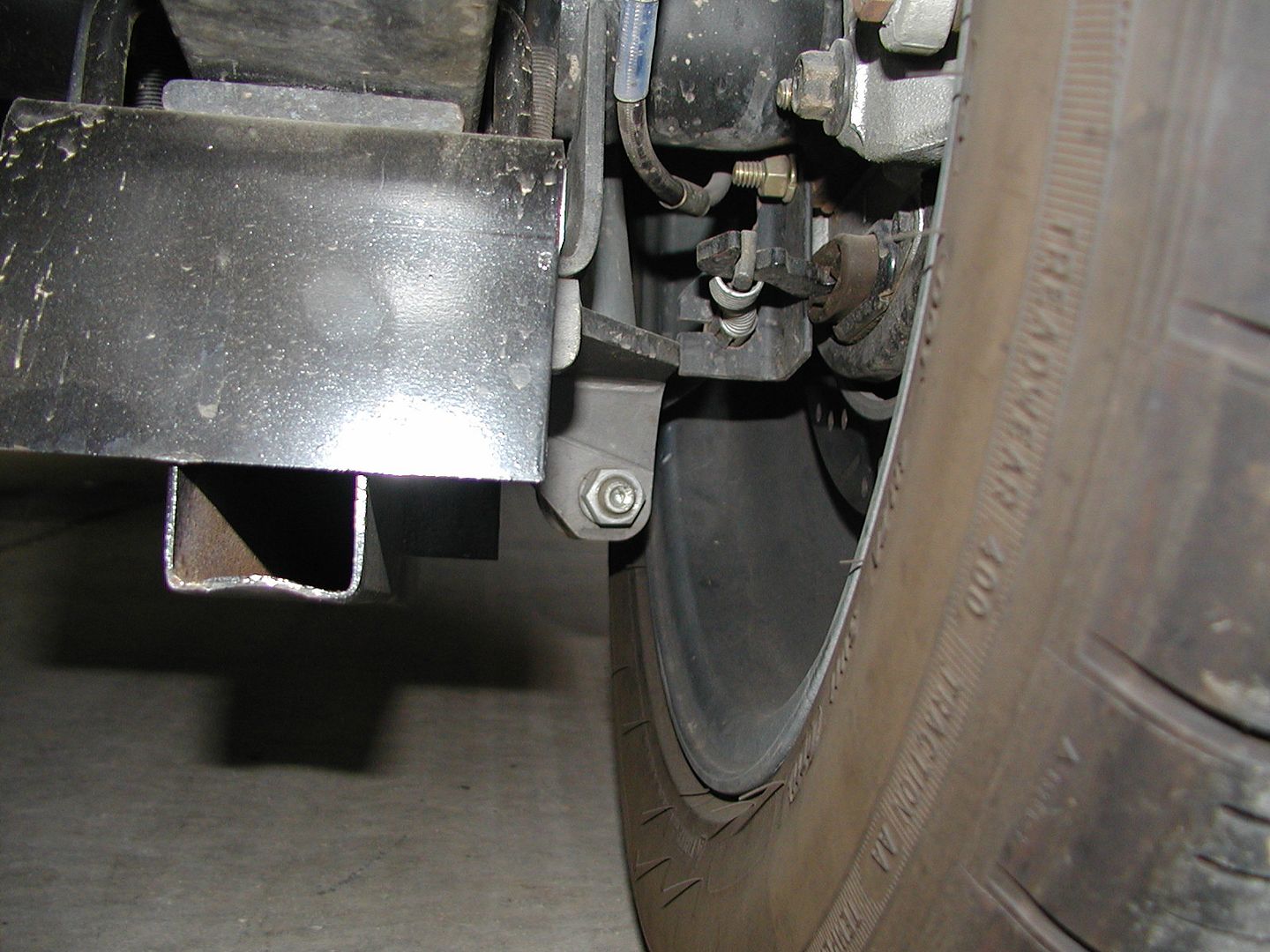

Philip, I would be careful of not using too much back spacing on a 15" rim. Here's a photo of my 79 with a 15" corvette rally and 4.5" back space before I pulled the rear end out. Notice the clearance between the lower shock mount and the rim? 5" back space is the most I would use with a 15" rim. A 17" rim might clear it. What's your shock mount clearance look like with a 17" rim?
I am running DSE lower spring plates but have seen stock 3rd and 4th gen cars with 5" back space and no issues.
With the 15x8 with 4.5" back spacing on the car there was just under an inch of space between the lower shock mount and the rim.
17" wheels give a little more room, this is with the 17x8 4.5" BS.
