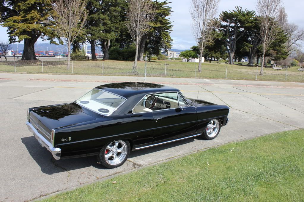

Right now I have my rear 6x9 speakers surface mounted on my package tray.I hate the way it looks:confused:I think it really takes away from the interior.I want to undermount them and I dont want speaker grills up top.Some have said speaker mesh to cover the package tray....the problem is my interior is a custom color and I can not find anything close enough......I do have a roll of the interior material that I can cover the package tray again.....Any ideas on how to let the sound thru?Is there such thing as a perforating machine?I could do just the 6x9 area of the material:confused:Any ideas??thanks bm

I'll try to get a better pic thru the back window but it's difficult with tinted glass
very nice.....thats what I want...do you know how they did it?thanks bm

I agree on the way it looks i hate it as well.What we did in Johnny's car was flush mount them under the package tray with speaker boxes on the underside.
The top side has acoustically transparent material covering the package tray.
What you see is a clean tray without any indication that the car has a stereo.
I dont have any pictures up close but this one gives you an idea from far away.
