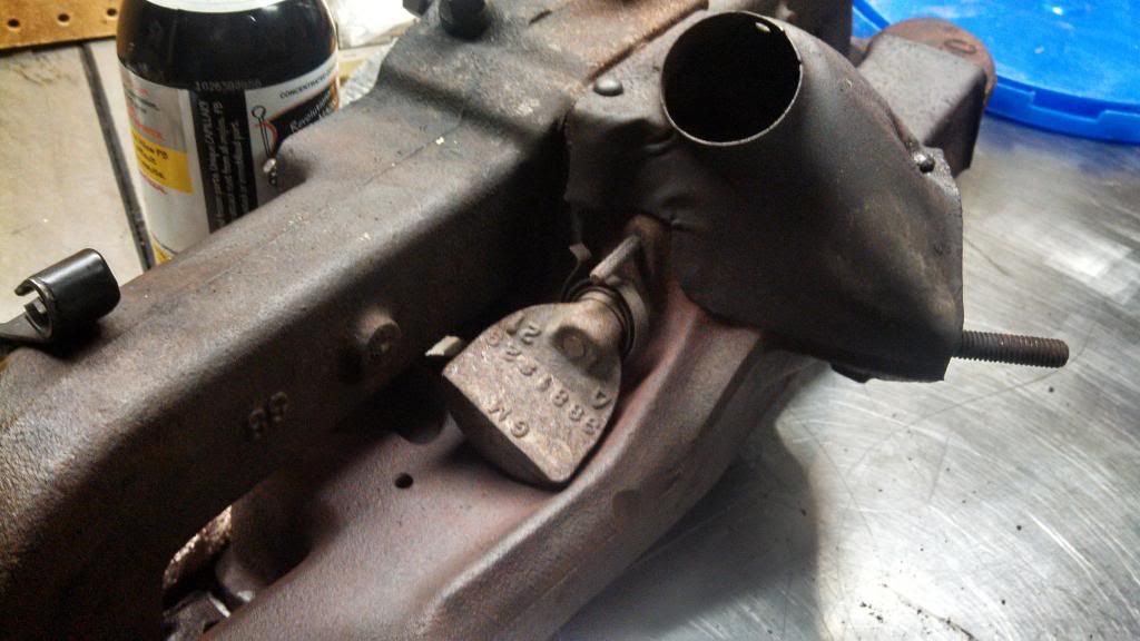

Hi guys. Newb here. Im pulling the 250 inline six out of my 72 nova to do a tranny swap and complete some other work. Got any reccomendations on things i should take care of while engine is out of the car. I got to fix a broken stud on the manifold and check out a crack also on the manifold.
Also the valve of some sort appears to have a broken spring. How can i fix this and what is it? its right in the cent of the pic
The valve is a heat riser valve, the spring is a thermal spring. Valve closed when cold, spring heats up and opens the valve. It's supposed to help the engine heat up quicker when working properly. They usually break, make sure it's in the open position and forget it IMHO.
Wire it open, if you forget to do that it will go tic tic tic tic tic tic tic tic tic tic and be really annoying. I had one of those valves go bad and it took a while to figure where the noise was coming from
