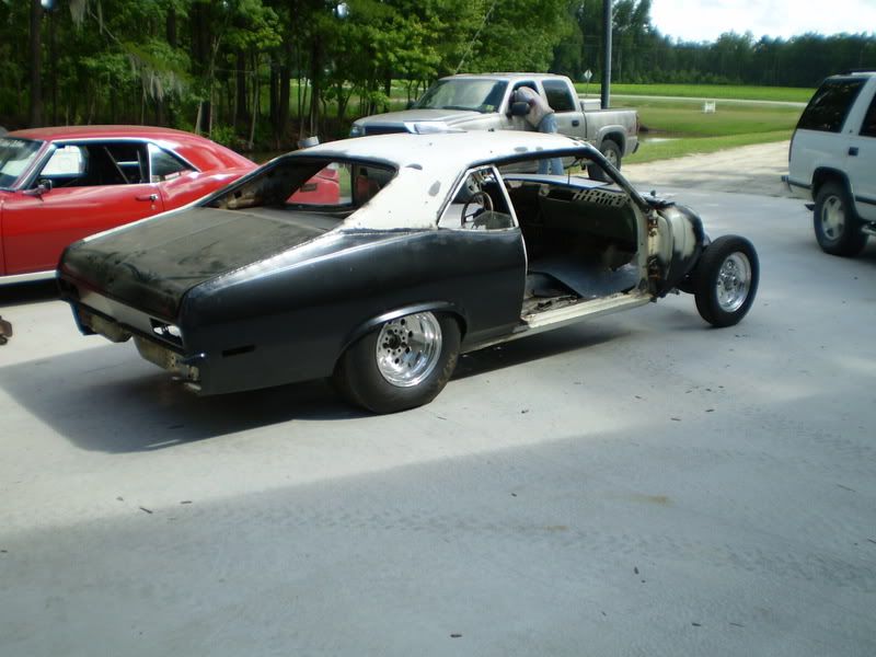

Here we have a 1970 Nova that I bought off top of a school bus in a junk yard a year ago for 200 bucks(with the title).
quarters, tail light panel, back window panel, and truck lid replaced. Ladder bars, dana with moser axles and spool, qa1 shocks, stock frame rails.

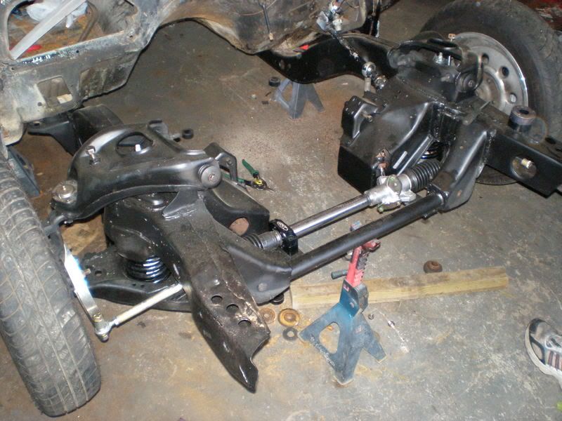

Rack, TRZ steering arms, drag shocks and springs.
New steel fenders, 6 inch cowl, fiberglass bumpers front and rear.... CM 25.5 started

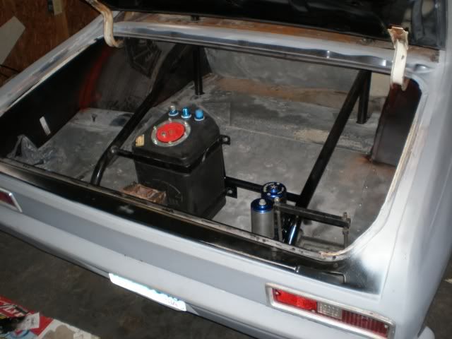

Magnafuel 500, The truck will be carpeted.....got the fuel cell cheap.

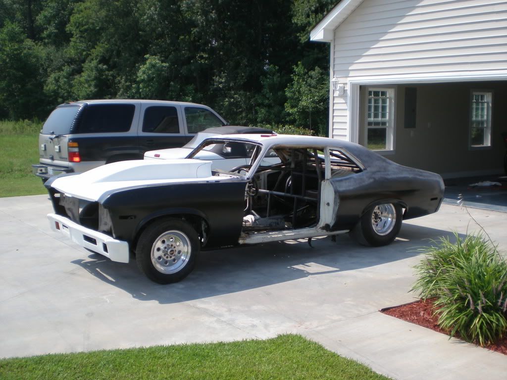

The car as it sits right now.... We have a radiator, MSD, driveshaft, new kirkey seats, and fuel line. I have $5500 in the roller as it sits. I don't need much to get finished-brakes, shifter, and time.
The car should weigh about 2900 with a 225lb driver.
