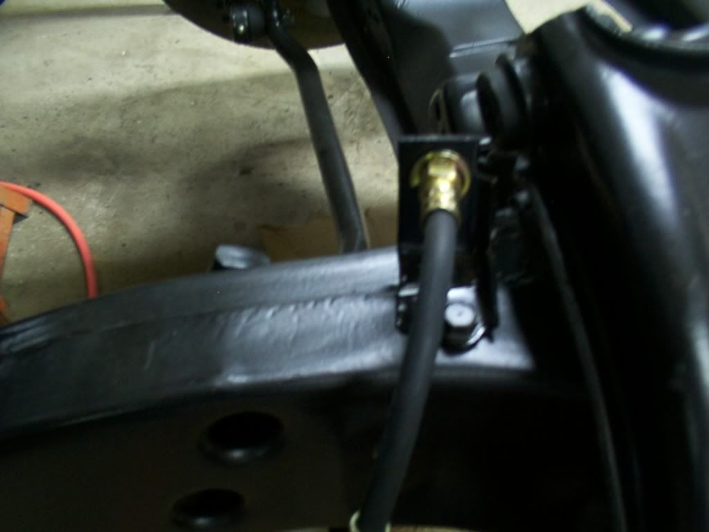

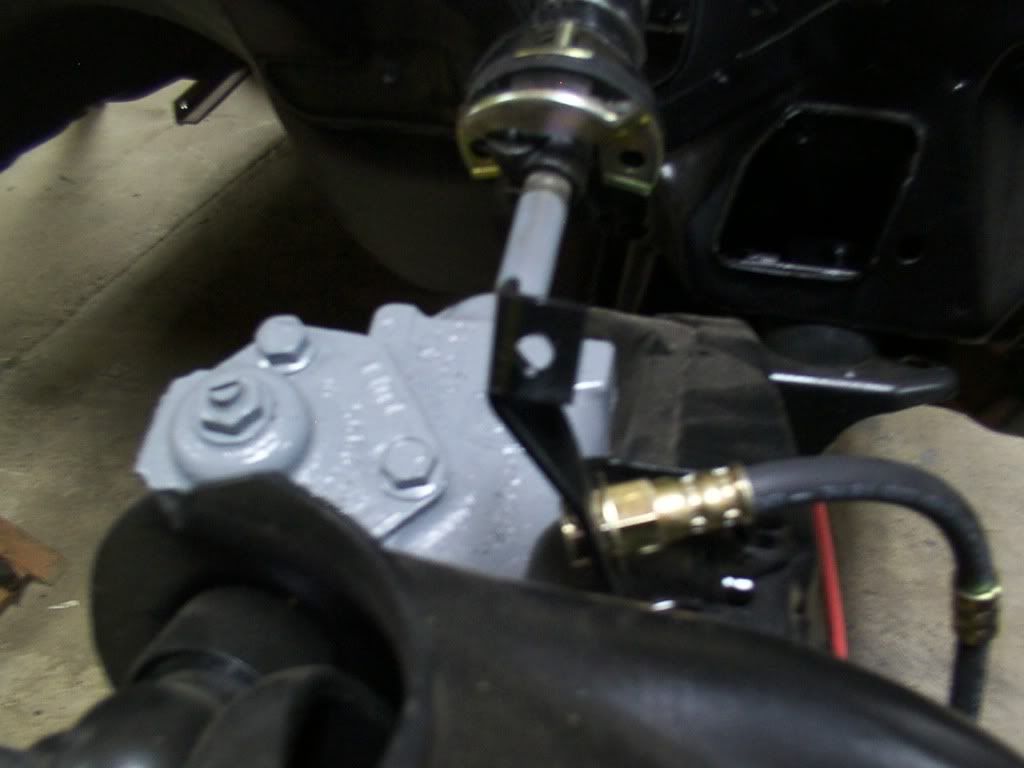

I did a search for a thread where guys might take photos of the "correct" way something is installed, such as brackets, springs, etc. But nothing came up. I have my front brake line brackets bolted on, but I'm darned if I can tell whether they should switch sides, hopefully someone can tell me if they are on the correct side of the frame. And is the gold band further down the hose where the funky looking clamp goes? Thanks.
The clamp goes over the steel reinforced piece on the flex line and then bolts to the upper control arm with a self tapping bolt.
