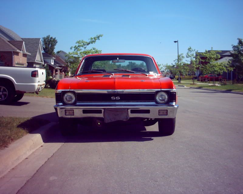

What exactly are the differrences between the pk lights on a 71 and a 69 i have a 71 and a fella told me my bumper is off a 69. its possible my whole front clip is bcause the base color is different.
any info on the subtle differences would be welcomed,
Thanks
sorry if this picture isnt the best.

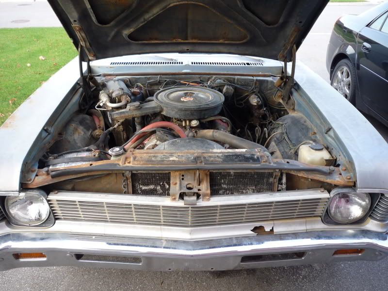

1968-9 front signal lights are rectangular and amber in color and the side maker lights are smaller for 68-69 as well they're in a different position. The grills for 68-9 have less vertical support bars only 9. Here's my 69 4 door. It looks like you have a 69 front bumper on your car.
This is my other 69, but it has a 70-72 style bumper on it with 70 signal lenses on it they were clear for 70, for 71 & 2 they were amber.
