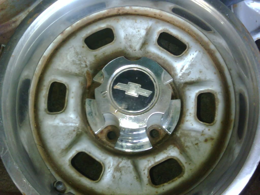

I wanted to do a set of 14" rally wheels but the center caps are rusty to crap. Can I get some other GM center caps for these wheels? Some of the tabs on the inside of the center caps are broken off. The mounting tangs on the rims themselves are rusty also. I think I can salvage the rims and tangs but the centers would be much harder.
I was bidding on a set of 4 center caps and lost by 50 cents on eBay. Sold for $10.50 I was bidding from my phone because there werent any bids, I figured I had it won! :confused:

That center cap is hard to find. I don't believe any other style will fit on it. I never see them, at least in good condition, at the various swap meets that I attend.
That style rim also came with small chrome inserts for the oval holes.

You could get a couple of 14x6 rally2's on craig'slist for $50 and use the center cap ring off of those to fix your 14x7's, looks like you can remove the rivits then weld or screw back on with button head bolts. Yuo could also try astro van rally caps since they hold on by the lugs, just paint them silver.

Thanks ALL for the ideas. Do you guys think these would work?
http://cgi.ebay.com/ebaymotors/73-87-Chevy-Truck-Rally-wheel-5-lug-center-caps-NEW_W0QQcmdZViewItemQQ_trksidZp3286Q2ec0Q2em14QQhashZitem56341e2159QQitemZ370241577305QQptZMotorsQ5fCarQ5fTruckQ5fPartsQ5fAccessories
I could grind the rivets off and remove those mounts and use the ebay center caps...if they fit. I will ask the seller to measure for me. The description says "They fit 73-87 old style 5 lug Rally wheels"
I found this pictuer in anotehr thread

I forgot to tell you the truck/astro centers are 5" pattern the chevy rally's are 4.75", Try looking at using the centers that were on the steel 14" 80's monte ss and camaro wheels, they were black but you could paint them to match the wheel.

Are they the same rally style or do I need to identify them first. How would I know what to look for? Basically look for 5x4-3/4 center caps?
1,989 Posts
Yes 5x4.75 and no they are a different style, 5 spoke, i think they are 14x6 or 7, same ones on 1985 monte ss. otherwise good luck, your best bet is to hunt for the one's you have or the 74' spirt of america nova type, to bad i sold my set of camaro rally 2's long ago for $50 and i had nice metal centers.
