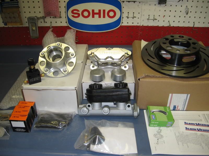

Got my new brakes and other crap today from Strange. I took off all the old front drum and old master cylander and weighed them, then weighed all the new, there is exactly 30 lb differance. Went to mount the new master cylander I got from them, (strange) and just my luck, it doesnt bolt up. There is about 3/8 differance in the bolt pattern. This kind of **** happens to me all the time. When it does, I get pretty bent out of shape and usually tear up things like a kid. I maintained this time, and will just have to see where they messed up. Brake kit looks awsome though, cant wait to get it done, Here is a pic. I will put one on after I get it done.

That kit looks sweet, keep us updated on how things work out. Will it go on stock spindles? I worked at SOHIO at King and Olentangy in Columbus when I went to college.

If I slot it, it will be VERY close to breaking out the sides, and on an aluminum body at that. they said it would bolt up, not a good way to start.
I had to do the same thing with my Aerospace Master Cylinder, at first I was like WTF! But after looking at it, it wasn't that bad, The one hole on the drivers side fit perfect and the other side I had to use my Dremel tool and elongate the hole to the point of almost breaking through the material but you don't.
Nothing is ever a true bolt with these old cars.

Strange kit is a direct bolt up. Yes, I use stock spindles. My car is originally a front drum brake car, non power. I paid $653 from dragraceparts.com. Dave, a friend of mine gets the best price, I shopped hard. I get a racer discount thru Jegs on most stuff, but not Strange, so I got the best price thru him.
