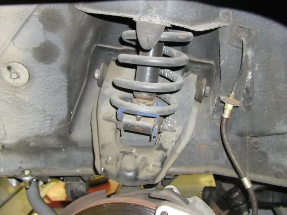

Here is the corner module with the stock arms. The first step is to remove the spring cover plate/bumpstop assembly. This is a bit of a PIA by yourself because you have to reach inside the engine bay and inside the fenderwell at the same time to remove the retaining bolts.
Next you want to attach a spring compressor and compress the coil spring so it is loose between the lower perch and upper retainer.
When your spring is compressed you can remove the shock tower and shock. Next you should disconnect your sway bar- I tried to get away with not disconnected it and there was not enough play to remove my ball joint. After removing the sway bar link remove the upper ball joint. I recommend you use a ball joint puller rather than a pickle fork, but its up to you. I have a small ball joint/ tie rod puller from Matco that works good.

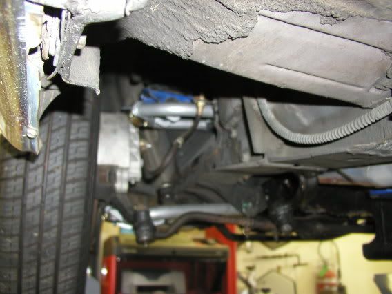

Next you want to remove the coil spring. Now the stock arm is ready for removal. The retaining nuts for the arm cross shaft are in the engine bay toward the bottom of the shock tower. These are lock nuts and when removing them a gear wrench is your friend! Here are the old arms:

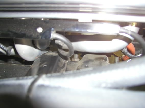

After you remove the arm remove the spring perch and install it on the new CPP arm. I used washers on the bottom side for piece of mind because the universal mounting design is slotted. Now the CPP arm is ready to install. I put the bolts on the engine bay side and the nuts on the cross shaft side except for the passenger side rear-most nut. The clearance between the hole and my header was WAY too tight to get a bolt in, so I used the nut on that side. FYI: I run Hedman Headers.

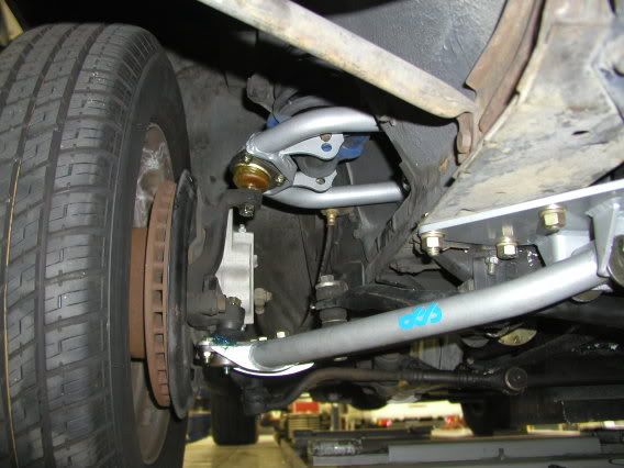

Here is the new arm bolted in. On the left side I slightly shimmed the front mount on the cross shaft to gain some slight “pre-caster” because I needed to center my LF wheel back in the wheel well.
Next install the ball joint in the spindle. My ball joints came with a locking nut rather than a castle nut- Im not sure if they will be that way in production. As with the lower ball joints from the mini-subframe kit, they are a tight fit and will not seat in the spindle quite as deep as the NAPA ball joints.
HINT: since the new arms are 3/16” shorter, it was easier for me to install the ball joint after I loosened the lower A-arm eccentrics and adjusted it inward (effectively gaining positive camber). The car has to be re-aligned anyway so moving the eccentrics is not an issue.

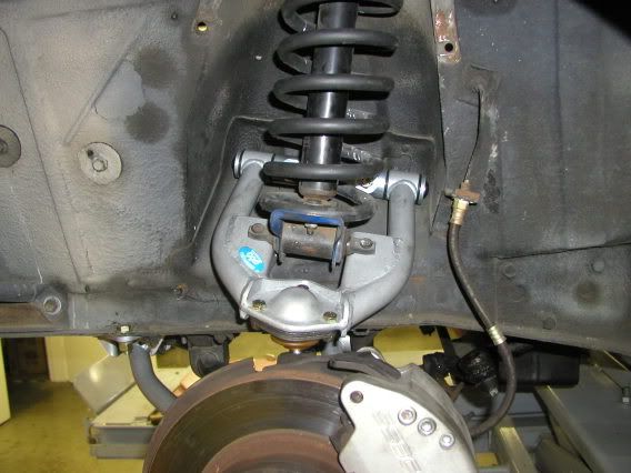

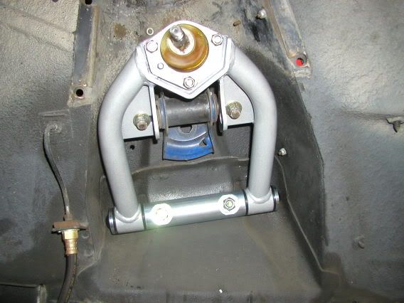

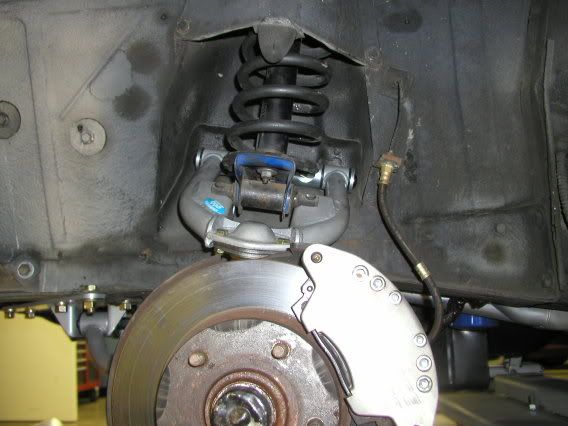

Here are a few more shots of the arms installed:
Alignment was a snap as before. I kept my specs the same as when I aligned it for the mini- subframe kit. I will probably play around with different specs at a later time, but for now I wanted to keep things consistent.

It appears in the pic that you installed the nut on the inside of the wheel well in lieu of inside the engine compartment like stock. Is there an advantage either way?
Should i use lock washers on the bolts (there is none in the kit)?
I reversed one of the bolts because of header tube clearance, but it doesn't matter how you mount it.
The kit should have come with squeeze nuts so there will be no need for lock washers.
