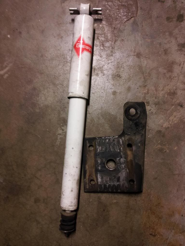

I bought a set of QA1 rear shocks and am stuck on the install because they are different from what i took off. i have a 68 nova and everything to the best of my knowledge is stock. Did i recieve the wrong shocks? or could it be ihave the wrong leaf spring anchor plate :confused:

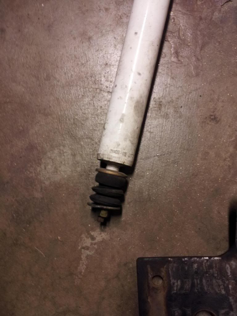

This is what came off
New QA1 shock

It looks like you have a different lower plate than stock. The lower loop has a bolt that runs through a clevis on the plate - ignore the two vertical brackets on mine, they are for my traction bars.
I looks like you have some sort of aftermarket setup, and it looks upside down too when you think about it as a front shock. You should be able to score a couple of stock type brackets, they will be the same part number with one shock in front of the axle and the other behind.

Traction bars would be sweet if your not already running anything like that. and they replace that mounting spot and give you a couple options for your rear shock. Your shock looks right tho as far as the correct ends. I dont know about the length.

Yeap can put some CE traction bars and they have the plate welded onto them already.

Just in case anyone is having the same problem I had I got the correct shock mount for the nova and everything bolted up perfect. I ended up going with the beefier DSE shock mount.
