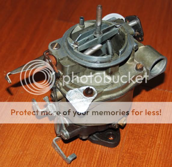

1st time doing engine work and Ive bought and installed a rebuild kit for my single barrel Rochester BC (or BV?). I am trying to make all the right adjustments before I bolt it back onto the manifold and I am unclear on a few things.
What are the things that should be done to the carb at this point before bolting it back down to the manifold hooking it up and turning the key?
Here are some pics of the rebuilt carb

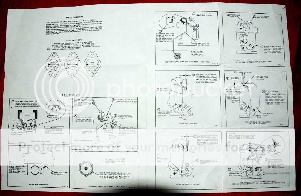

I have both instructions from the kit and the shop manual details and Im seeing that I dont have the right feeler gauge set for the adjustments I will need to do. Looks like tools J-21216 and J6838 are needed to get thicker gaps set.

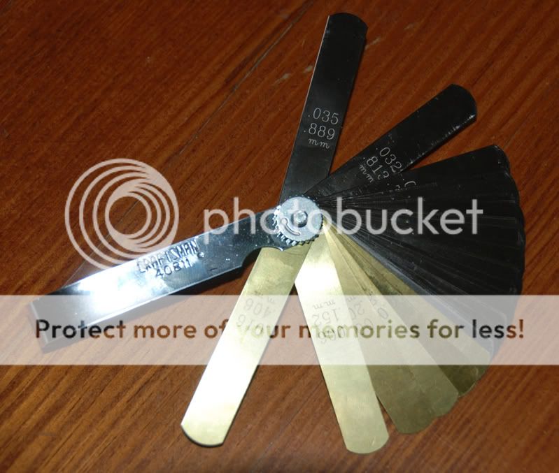

Here is the set I have, is there a set that anyone could recommend?

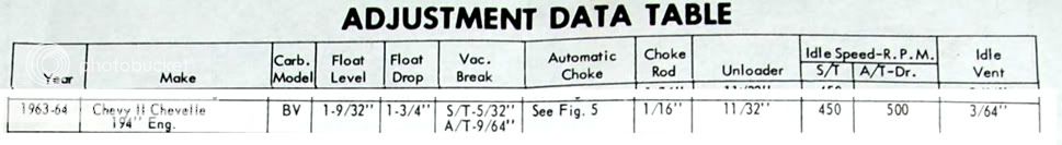

The vacuum break adjustment questions:
  1. Are all three steps in the instructions supposed to be done simultaneously?
  2. Am I supposed to be pushing the diaphragm plunger in while I am closing the choke valve while I am also setting a gap of 9/64"(since its an auto transmission) between the lower edge of choke valve and the wall of the air horn...all while making sure the choke rod is at the end of the slot?

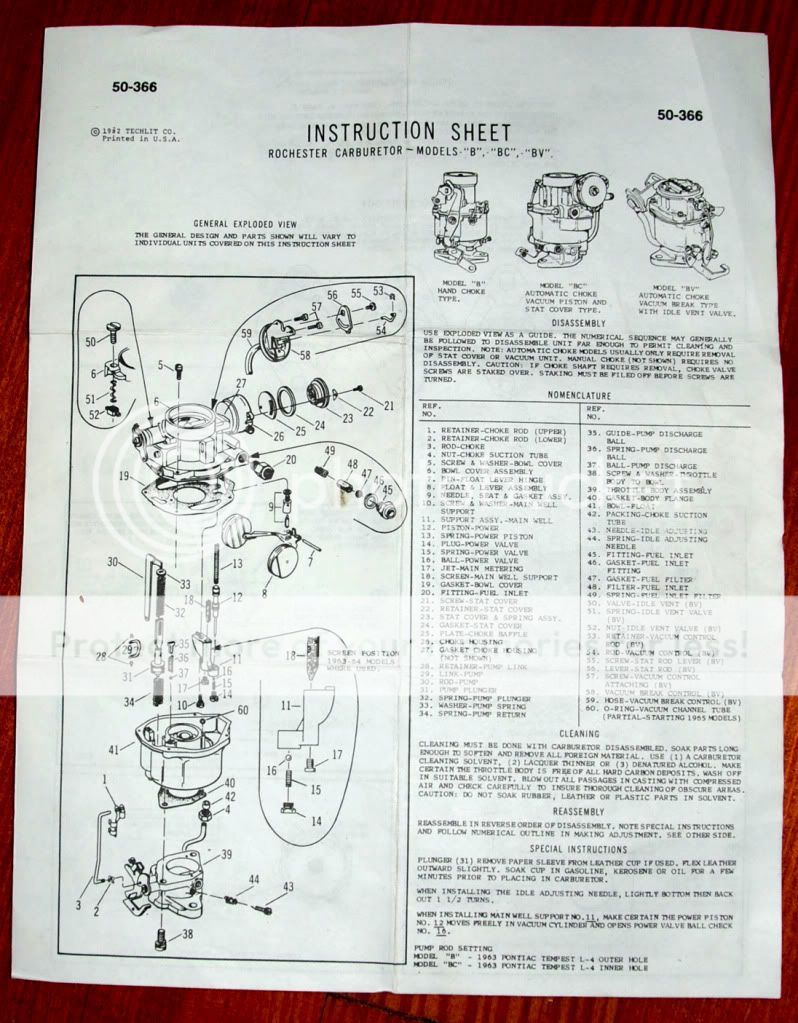

Here are the instructions that came with the kit

I just finished doing the same job... All adjustments should be done on the bench, this way access is easy and you don't have to worry about dropping anything down into the intake.
You will have to do two of the three steps in the vaccuum brake at once. You must use a vacuum source to actuate the plunger (simulates engine vacuum). Best way to do this if you don't have a mechanics vacuum pump is to use a length of hose and suck on it to close the diaphram (backyard, but it works). Use some drill bits instead of the feeler guages, these are common sizes in most sets. bend rod slightly to adjust and repeat the first two steps to check measurement.

A drill bit is an excellent idea, way to break out the old ingenuity!
You could also stack your feeler gauges, i.e. .035+.032= .067
I realize that's a lot of feeler gauges to reach .141 or 9/64, so I gotta say I'm lovin the drill bit idea.
