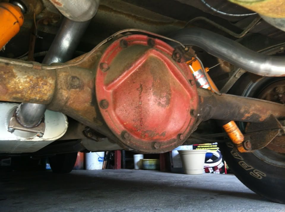

Hey guys, I'm pretty sure it's a stock 8.2 10 bolt but the diff cover is throwing me off. All the charts I see doesn't show this weird looking cover. It's in my 66' hardtop I just picked up. Any help is appreciated!

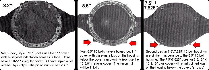

Looks like an 8.2 from here. I think Big Al posted up pics up the 10 bolt before and the 8.5 has a flat lug on the bottom of both sides when looking at it from the back. The 8.2 takes a 1 1/8" socket on the pinion nut and the 8.5 takes an 1 1/4" on the pinion nut.
It looks like a 8.2
