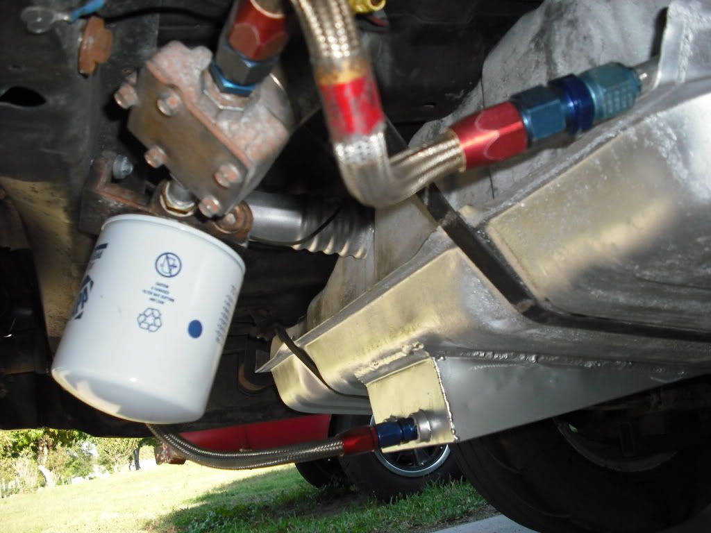

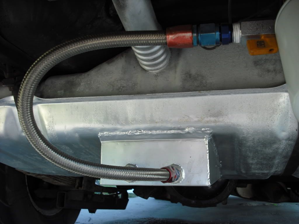

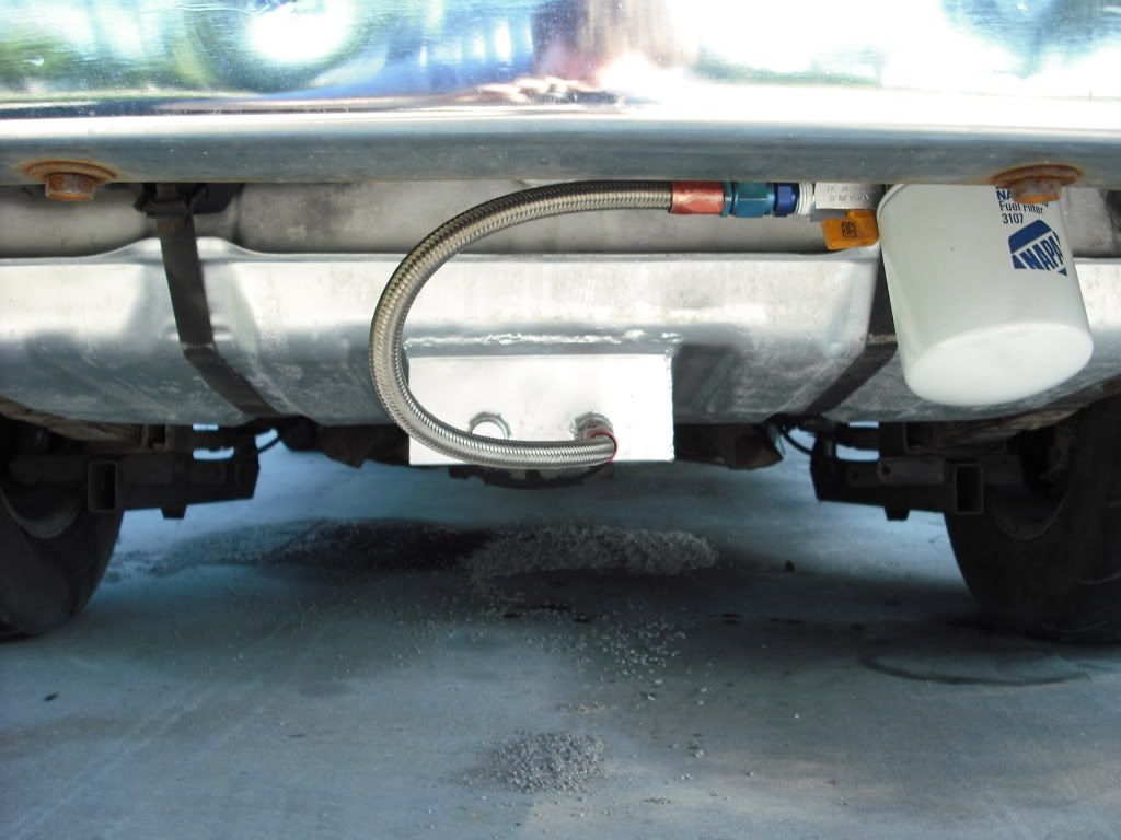

I upgraded my fuel system on my car. I had a sump welded onto the bottom of my gas tank, then -8AN Fuel line. My neighbor sold me the AN fittings I needed for 1/4 the cost of new fittings.

I'm still trying to work some bugs out, the car runs good thru first and second gear, but once in third it will start to pull then the RPM's drop and it wants to stall. I think I need to jet up

Hope these aren't dumb questions. I also read where somebody (not necessary a Nova) had issues with sump in a stock tank and stock baffles blocking pickup.

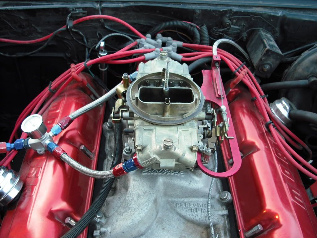

I have no fuel gauge inside, the carb is a 850 race carb with 50cc pump and annular boosters. I have always had the Napa filter, and now I wonder if that's my problem. And I know it's not the rev limiter chip because it allows me to go all the way thru first and second gears before it starts to stall and buck untill I let off the gas.

I would try relocating the filter. That pump pushes very well, but really needs a good gravity feed as it doesn't suck well.
The other thing I would look at is your regulator. I run two of those on my dual quad setup. It's funny to run 1/2" line all of the way, then let the little orifice on the inlet of the regulator choke things down. Not very scientific, just my opinion on those regulators.
How much pressure are you running?
526 Posts
That is fine for the street, but I would run at least 9lbs at the track. Holley says the needle valve is good for 13 lbs. Are you running the Moroso spring in the fuel pump? I forget what the pump will produce with the stock spring.
