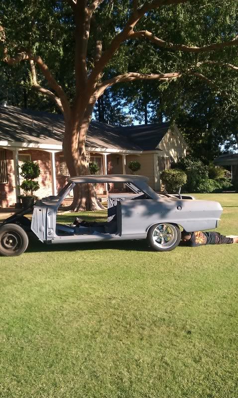

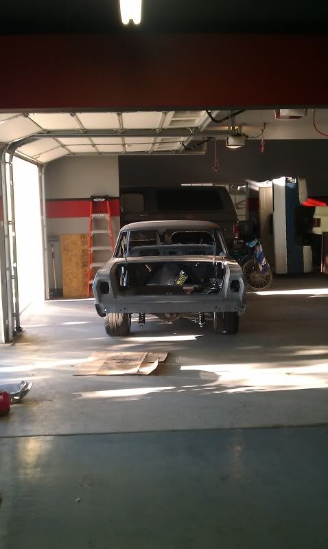

My buddy has been stockpiling parts for his 62 for about 6 years and we finally started working on it last week. We made some room for the big E.T. street radials. and we got the TCI 4 link put into place to check the fit and clearance of everything. Thats a new 9 inch with a big moser axles and disc brakes.
1,725 Posts
How wide are those rear tires and wheels?
103 Posts
Discussion Starter #4
I believe the rear wheels are 17x10s the tires are almost kissing the frame rail in the rear where the frame widens out. So we're going to need to see how much body roll there will be and then possibly doing more work on the frame.
