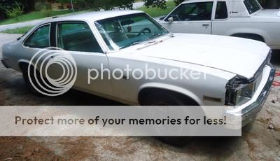

Additional Comments:Finally found the car i grew up riding in...well one like it. I've only had it for a month. My granny had a green one and i loved it as a kid even though it was only a inline 6. Now that i have my own i plan on making it my own five speed big block with a new edge twist

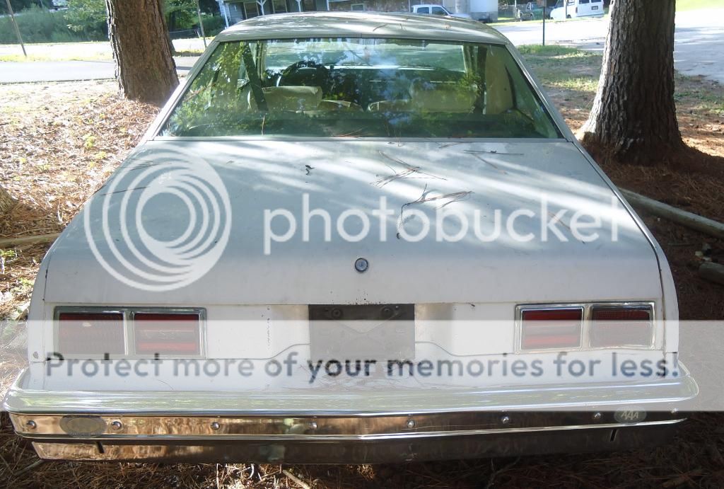

Looks a really solid start!:yes: No rust at all that I can see in pictures. Sounds like a great plan with a big block & 5 speed. Maybe one challenge will be to find the clutch linkage & pedals...but they seem to be out there. Look forward to watching the progress. By the way, welcome to the site. Lots of guys to help and lots of knowledge.

here's the rust. not much but it's first on the list.
trunk:
rear right window:
back window:
right rear lower panel:
rust first then hunt down some of the missing and broke body pieces.

Looks to be in good shape as a starting platform. From the photos posted I may be able to help with the missing and broken body pieces. Send me a PM when you are ready for them.
