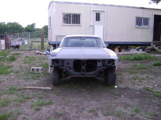

after seeing crazy 88s 69 build(which was great btw lol) i thought i should go ahead and get started on mine im pretty sure you guys know what i have but just in case hear it is ( sorry that some pictures arent that big)
my 74 soa which just recently i found out that the doors are 68-72 which means the panels arent gonna be a pain to find
brand new radiator support and inner fenders

good to see the car. now lets see the damage :devil:
oh and what dose the front end and rear end look like on those cars?
