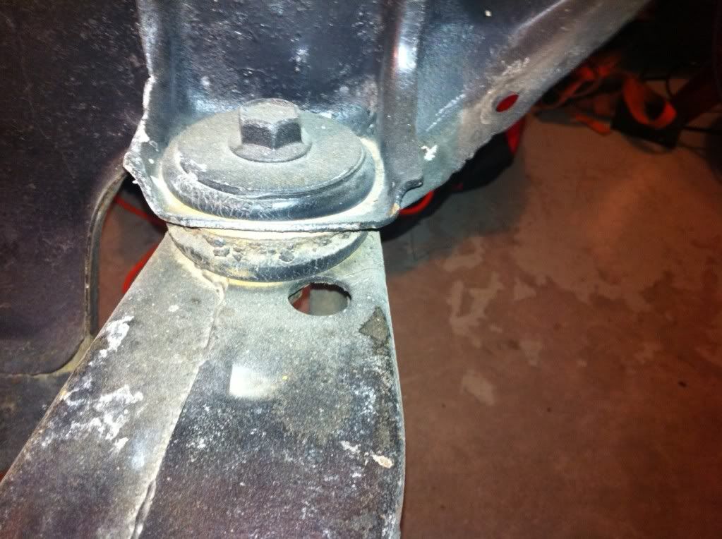

Didn't take long - and only two sheared bolts..:mad: Interestingly both the same bolts on either side of the car: one of the top rear shock brackets.

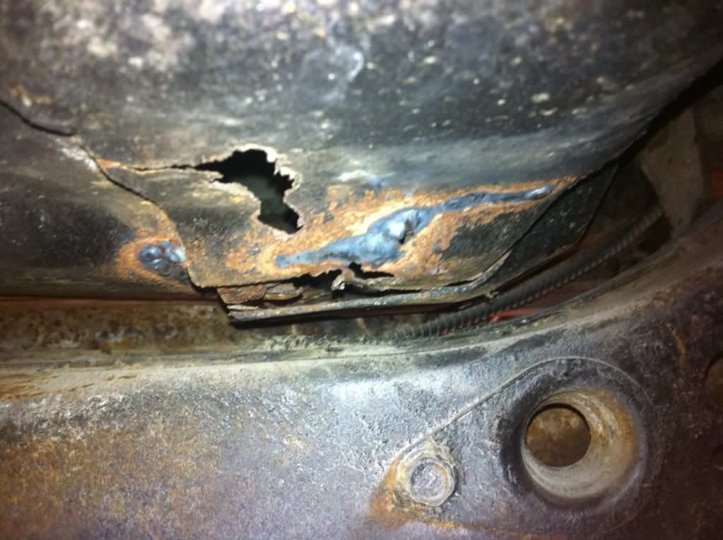

Admittedly it didn't look "too" bad so I carried on under the car removing the fuel and brake lines... And then... this popped into sight.:mad::mad::mad:
It is a really pathetic half-a-donkey fix. And worst of all it looks like I'm going to have to take the sub-frame off to get decent access.:doh: Somehow "mr.welder" managed to seperate the spot welds so the whole panel underneath is splitting ON TOP OF the nice big rust holes..

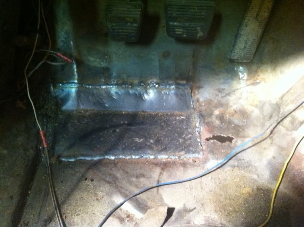

I had to stop the cleaning until I could get the sub frame off. There's still that huge hole in the driver's foot well I need to tackle before finishing.

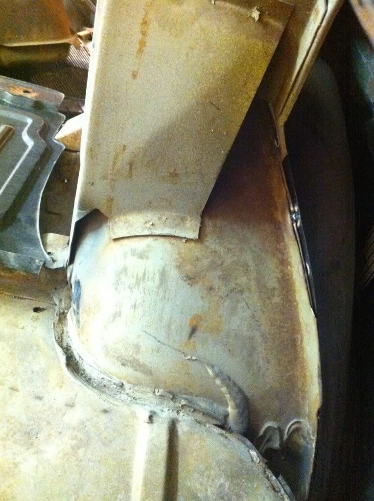

Didn't get to take many pictures today.. This is one I took before I really started. It was to show the gap between the inner and outer rear panels of the wheel well...
It was nearly 5mm in places and had 1 or 2 big holes.
I thought my solution was a pretty good one. I bought a thin steel round bar about 4mm across and welded it in the gap the whole way around. It's not nice and sealed. As soon as I make everything neat and pretty I'll take another shot...

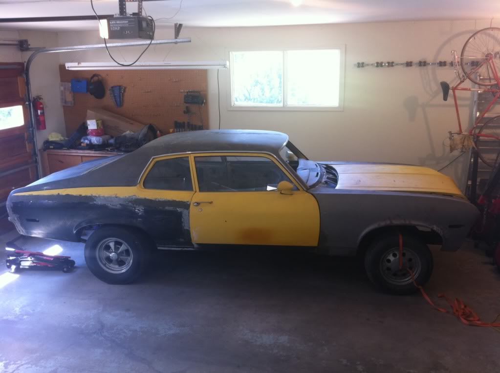

Basically if you look at the picture below:
I took some measurements of the door openings today and found a little inconsistency. The Driver's door is about 5mm wider that the passenger - measured at the same spot on both sides.
I noticed because the driver's door, when closed, seemed to have a bigger gap between it and the roof/channel above it.
Is there anything I can do? Is this indicative of a more serious problem? should I be concerned?:(
Anybody?
Thanks...
