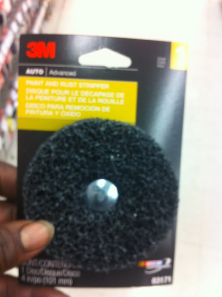

I USED THIS AND RATTLE CAN FOR MY :ragtop:
