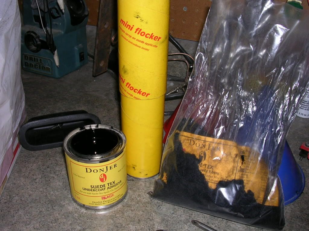

here is the "flocking" kit I have mentioned in the past, great for giving stuff a velvet/suede finish and is supposed to be real durable (think duck decoys)
THe kit (mini flocker kit)

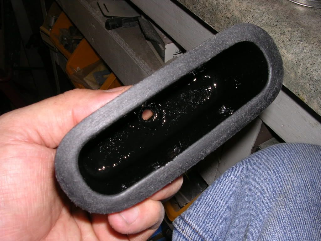

the part with adhesive (color matched) this is one of my door handles inside

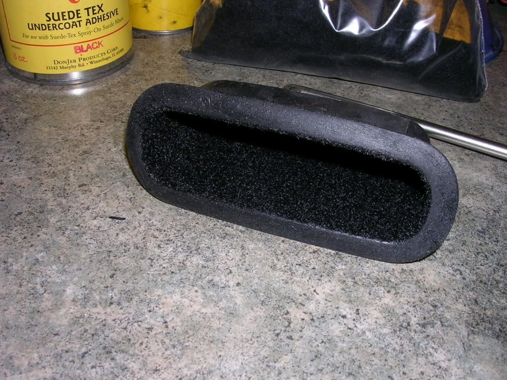

here is the part "flocked"!
part will look alot better after about 12 hours drying time and you blow all the excess off...

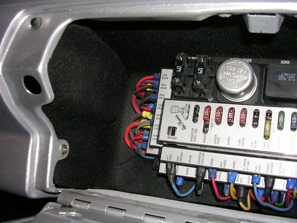

here is my custom fiberglass glovebox flocked and dried - looks nice
